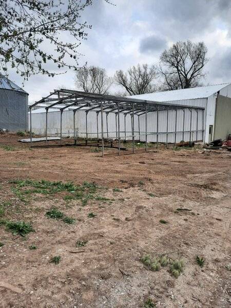

Here’s mine going up- and built, ready for concrete and driveway. I’ll put up a more current photo with the lights and everything later
View attachment 1111534 View attachment 1111544
It looks like you don't have a poured cement foundation. After foundation was poured for mine I had to have it inspected by town and was questioned whether there was rebar in it. Luckily I took pictures as it was being poured but the architect had to sign off that rebar was installed. Then they had to inspect framing and that hurricane braces were installed.
No foundation for a pole barn. Poles go 4 feet down and sit on 8x24 inch round concrete footing. Then it’s built kinda like a fence with a header on top that the trusses sit on. The floor is poured inside it. Rebar and mesh.
I had a footing inspection, framing, rebar, then final. In that order.
I would have loved to do a foundation building, but it’s a champagne taste and beer budget kind of thing.
Anyhow I have my space and it’ll last longer than me.

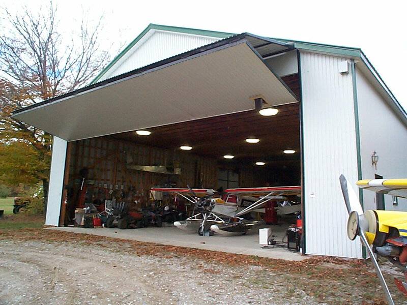

I knew what you were talkin about, but I thought I'd let you hang yourself some more! LOL Shop is 60' wide x 30 deep, wish I'd done 45 deep. 50 x 100 hangar is pretty full most days and too much work to make mouse proof, let alone insulate and heat the bugger. I was going to put a bowling lane in the "attic" originally... lol

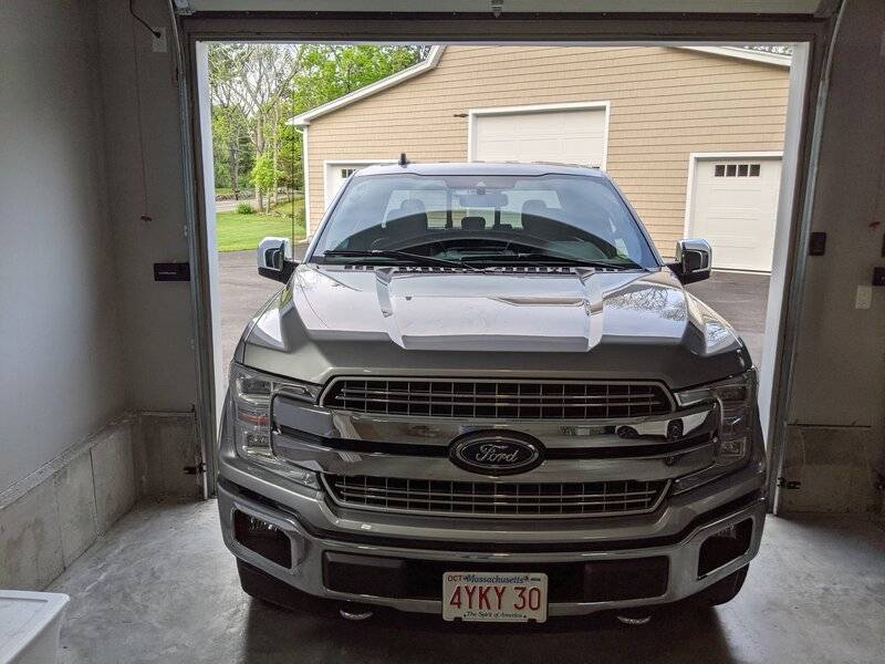

If you drive a pickup truck in, you'll wish you had 10 footers.
My truck has about a foot clearance on each side with 10' wide doors, which is comfortable.. My old house had 9' wide doors and I had to be extra careful pulling in or out.
