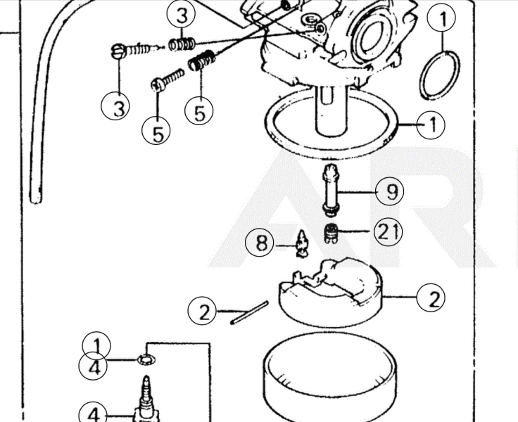

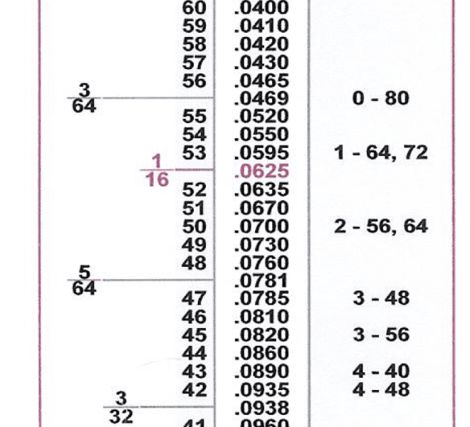

The brass main nozzle is stuck. I ran the body in my ultrasonic cleaner for 3 hours, no luck. It's #9 in the photo and has an orifice that is .063 inch diameter. A 1/16th tap? It's sunk in about one inch. I was thinking of using a tap, but that's a last ditch tactic. Any better ideas?

Are you trying to unplug the jet? Appears to be #21
Put the largest diameter drill bit that will fit into the tube (to not crush the tube) as far as you can and use Vice Grips (with a ton of pressure!) to twist the tube out.
Most all the brass wells in carbs are pressed in.
Mike
for some reason, they have that tube (like the carb, no longer available) in between the Main Jet and the mixture screw. It is recessed from the Jet, which has an orifice the diameter of a paper staple. The tube has an o-ring and I want to replace all of the o-rings, carb and tank, while I have it apart. I don't think I will have to tap the tube. I'm hoping the tap will bind and the tube will spin.

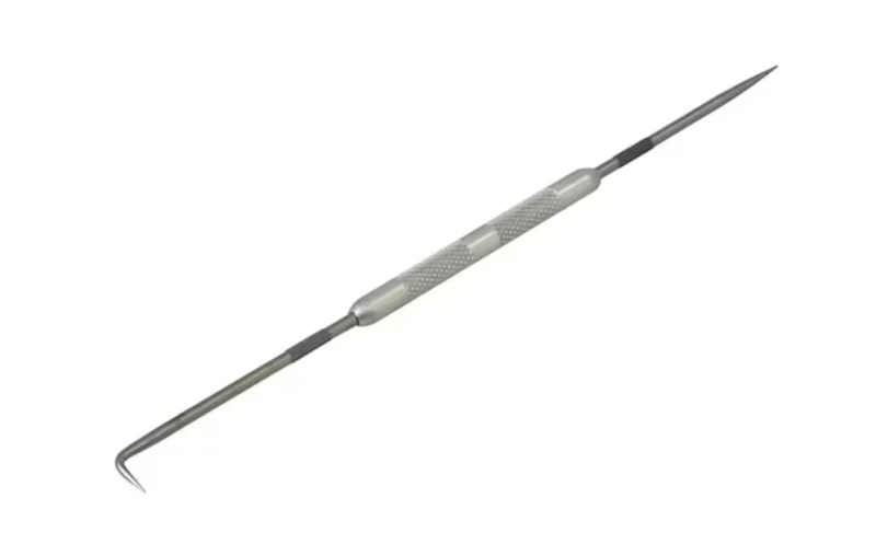

I would sacrifice one these, but it is too large of shaft diameter. Would Snap-On have a suitable pick?
Your #9 component is called the MAIN NOZZLE....and it SCREWS into the carb body,. #21 is the main metering jet. REMOVE main jet first then access the main nozzle by unscrewing it from the body. The main nozzle has emulsion bleed holes in its body which can become clogged. Carb looks like its from a Generic power washer pump.....just my opinion of course.....
