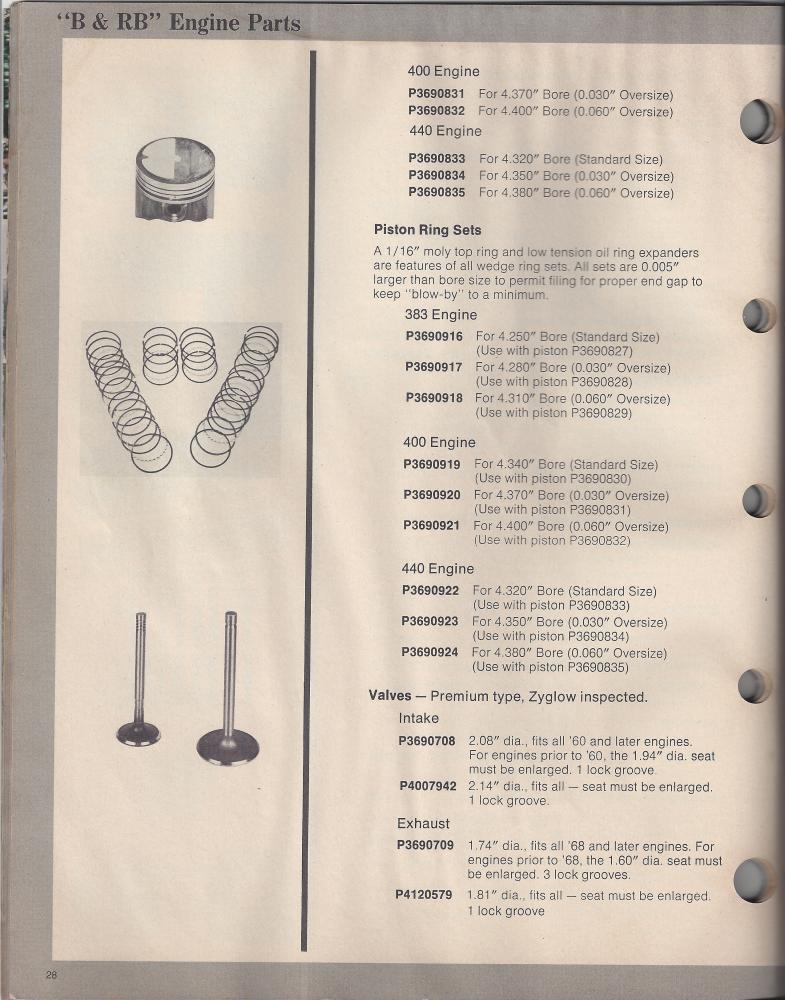

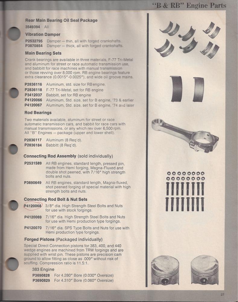

Direct from the source -
From the catalog pic (assuming that is what you have) they are forged and likely a 2618 alloy - so they will run about .005" to the wall. That clearance is considerably looser than stock cast but normal for these. I would be more worried about bore distortion on a .060" over 400 rather than overheating. Get it sonic checked before you go that far.
