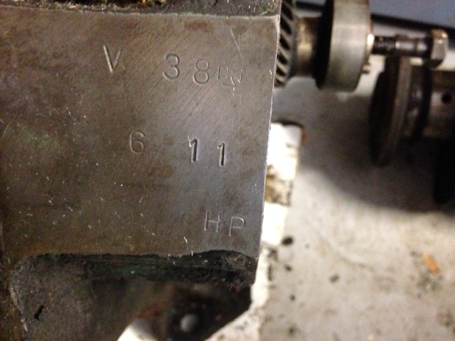

I have a 64 383 that is stamped HP.View attachment 191712
