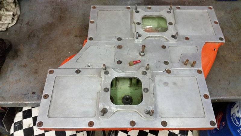

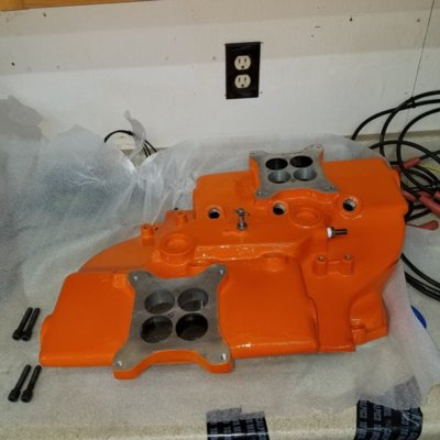

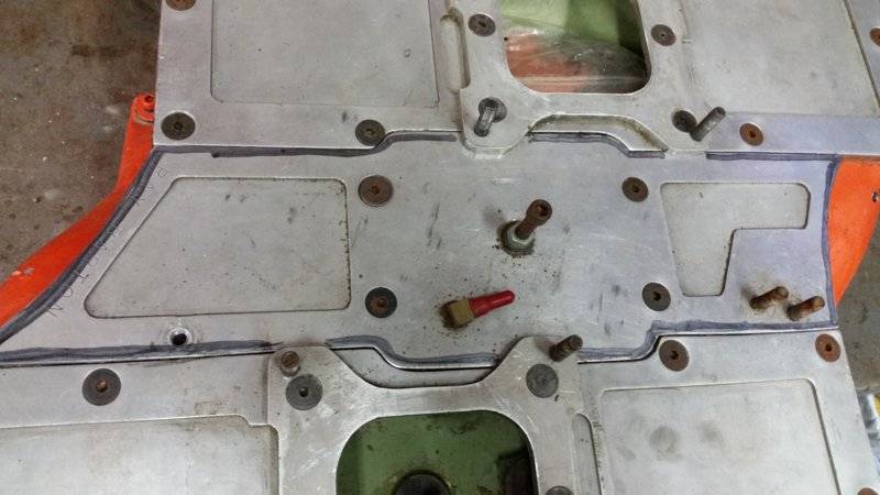

My Hemi Ray Barton manifold has a green epoxy of some sort all over the entire inside of the plenum are & all of the runners I assume to keep it from deteriorating. The outside is painted Hemi orange but when I handle it i can still feel a powdery feel.

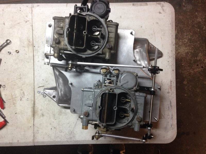

making a little progress on the STR-8 manifold for the 383, decided on the holleys instead of AVS carbs. one of these carbs is just for mockup.
