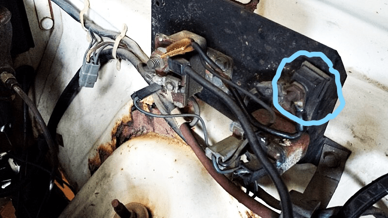

Adding to the above - what is the gizmo I have circled in this picture of the 66 relay panel?
The wiring diagrams call it a "terminal block" but that doesn't seem to show up for sale in all my googling and parts house searches. It appears to show the eyelet pig tail bolting to it and the terminal pig tail going to the plug on the horn relay. Anyone know where to buy one of these or what to call it?

That pic looks awful familiar to me.
Really - found it on the internet in a Google collage of photos. Do you know what that gizmo is and where it can be found?
If you find one expect to A LOT. Saw one on ebay 5 years ago $300. A piece of plastic with a stud in it?

I guess I'm famous, then? LOL I'd recognize my rust anywhere!
I don't know what to call it other than what you mentioned. Maybe check with Tony D'Agostino - Tony's Parts?
Is it just an isolated (ungrounded) terminal point?
Not sure never really looked. Wiring diagram for that can't see it in mymopar ones.
Fran - This is from the 66 Hemi Supplement to the FSM. I assume what is circled in red is the terminal.
It looks like it's just in-line between the bulkhead connector and starter relay terminal. I don't see any other lead connected to it?
