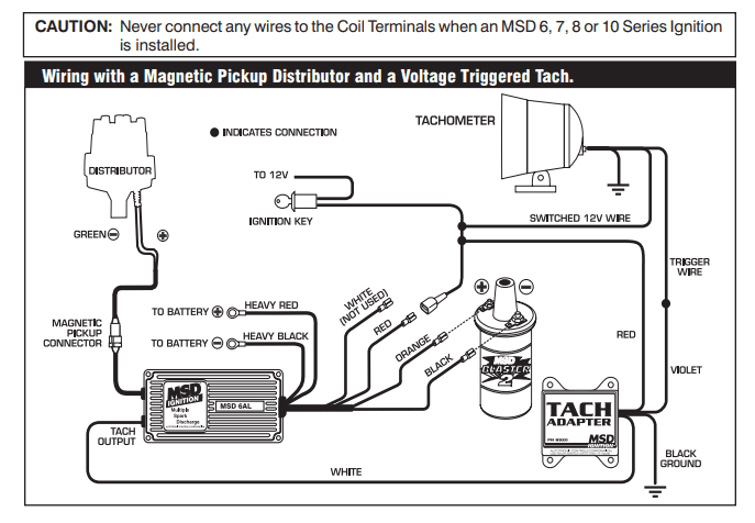

So I finally got the in dash factory tach in my '69 GTX connected to the MSD ignition system, I added a MSD 8920 tach adapter, and sure enough the tach now works, but reads 2X (ish) the actual rpms. Any ideas?

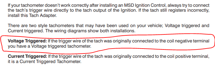

Which wiring diagram did you follow on the Instruction sheet? I have installed 3 of those, and all of them worked fine - Mopar's and a Ford.
You should be using this one...
Yep, thats how its wired.
