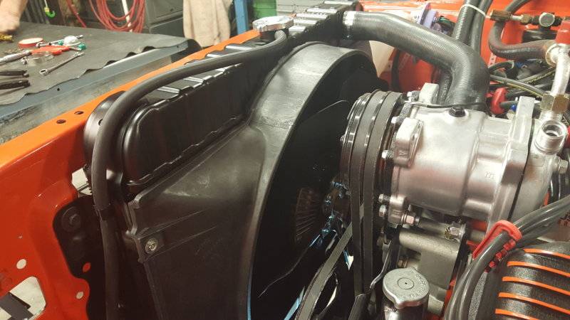

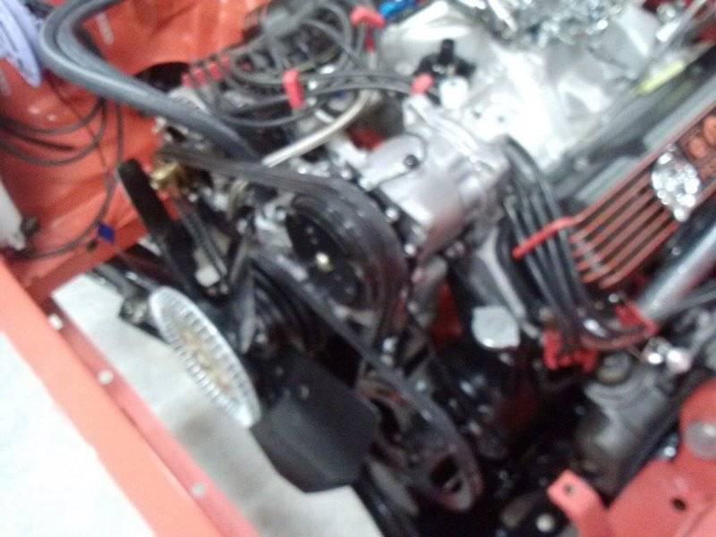

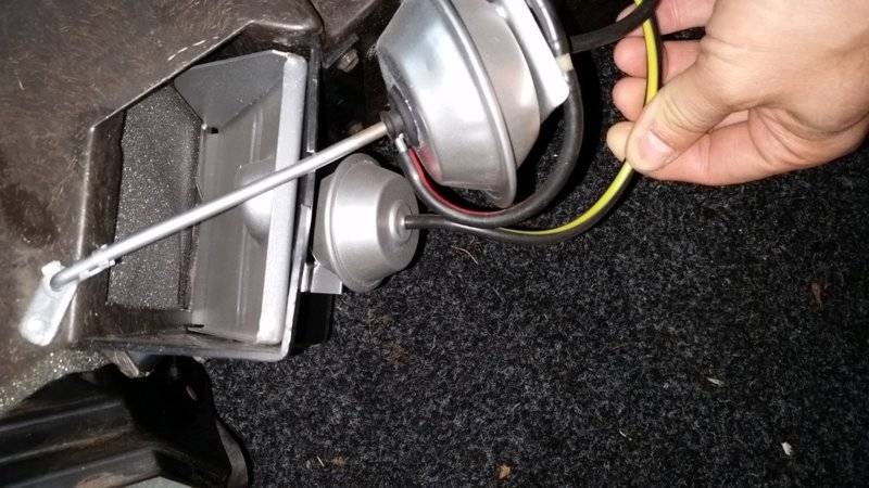

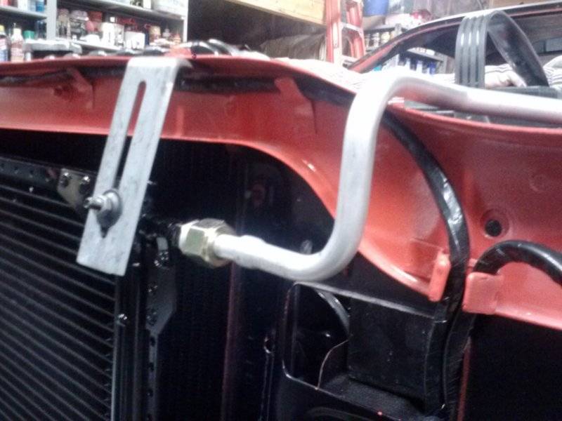

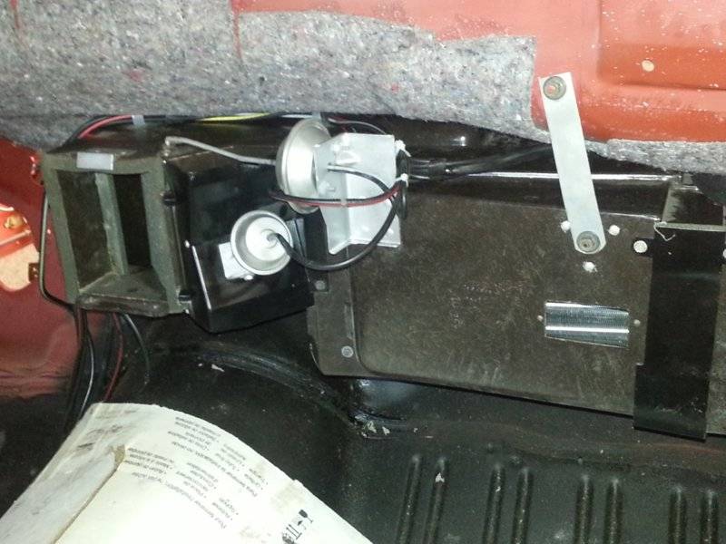

My car originally had A/C from factory. I rebuilt my heater box, checked the pods (and found a "new" one on ebag), made my own aluminum hard lines. Bought the compressor, mounts, condenser (exact original), drier from Bouchillon. I don't know if he got/gets some stuff from Vintage or Classic but it works fine.
