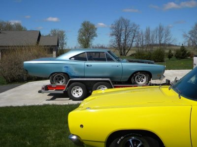

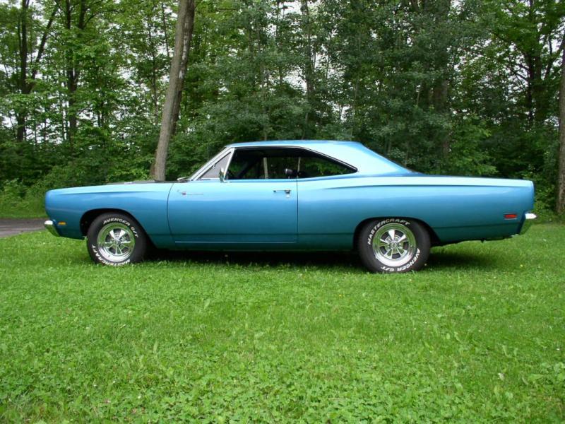

Thats a nice looking bird Elk has there! Will,That drive train is going to make it come down for certain, but it appears in the pictures there's enough space there that it would come out just about right, planned Will? or am i guessing.. Anything that looks good on this build doesn't surprise me watching all of this come about.
Thanks Ron...You guessed it, planned out that way and it's coming together thus far thankfully. A guy almost needs to have a crystal ball to envision all the details of his build, but thanks to folks on here, their ideas, suggestions and rides sure makes it a heck of a lot easier. I remember on some of my other earlier resto's I would actually take the time to draw the car out to see what color of paint or wheels would look like on the car. Kinda miss doing that stuff. Maybe next car i'll do both.
She's coming down in the front Steve, just like Jay mentioned....I'll get about a 2" drop in the front from the drive-train, just enough to make the wheel opening about level or just a tad lower than the wheel. My driveway has a bit of a tilt towards the road, so her stance now looks like a rake to the front, but that's deceiving. Once the drive-train is in, the car will have pretty much the same rake to the front as the picture above appears to have. Only difference is the front wheel will be higher into the wheel well.
I based my rear wheels height off my desired RPM at highway speed with the 3.91's as well as Hunt2Elks rake on his bluebird. My rear will be about an inch higher because I have the Cal-Tracs underneath. Same springs/tire height though.

Well Will, that was nice to see my car sitting outside on green grass. It really makes me anxious to run it through the gears again this spring. It is patiently sitting under a cover while I spend all my time on the Charger resurection.

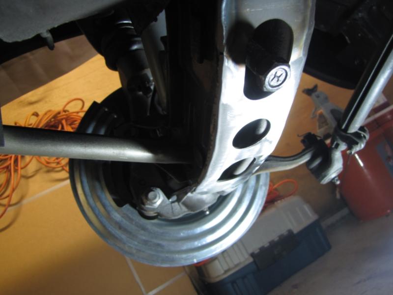

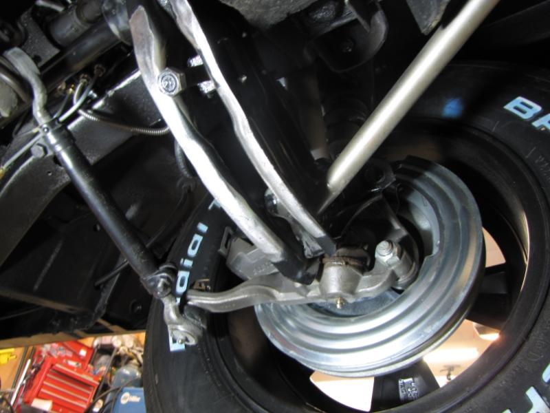

Decided to install the PST lower control arm stiffening plates, while in the car. Thought I'd post the install for those that were thinking about putting these on their own rides.

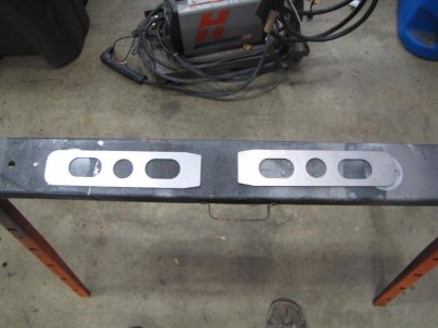

Plates look to be water jet cut...Nice quality, good price. Metal is 16 gauge.
Coated the backside of the plates with a couple coats of Zinc based weld-thru primer. Welding them on would burn off regular paint, leaving them unpainted they would rust. High Zinc content in the primer should hold up find down the road. Also cleaned the paint off the bottom of the lower control arms and sprayed some weld through primer on the mating surface.

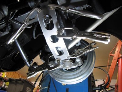

Took of the wheels (avoid weld spatter), parts jigged up just fine..
Just hit it with the MIG, cleaned up with a tiger wheel..

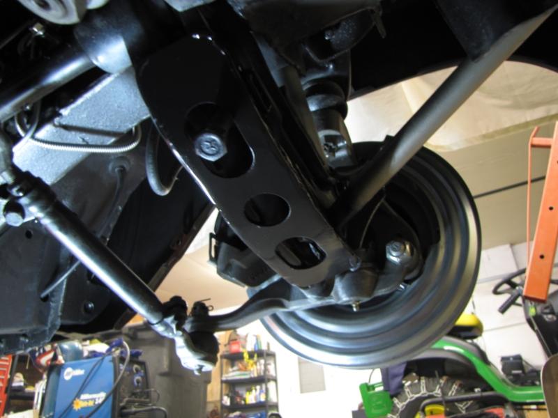

Sprayed on a couple coats of Chassis black and called it done.
Overall, pretty easy to install in the car. It would be obviously easier out of the car being wedged upside down between a k-frame and cement isn't the most premium position to weld, but never the less still very doable. I'd say all said and done, if one was moving right along, you're looking at 1-2 hours worth of work.
