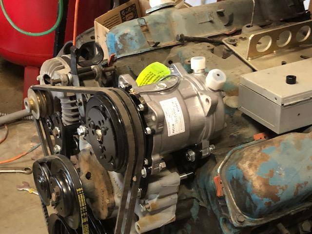

Before I did the Classic Auto Air installation, I had a NON A/C setup.
I didn't like how "busy" the 4 belt factory setup looked so I tried to see if I could make a 3 belt system work. 2 belts for the crank, alternator and A/C compressor and the 3rd belt for the fan, crank and P/S. I couldn't find a fan pulley that would work.

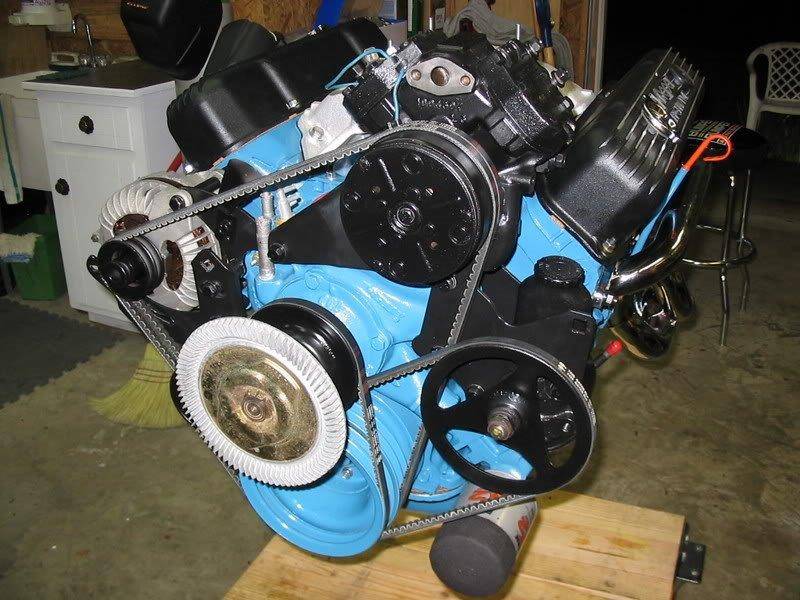

THIS is what the stock setup looks like on my mock up engine. This is without the P/S pump.

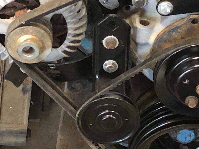

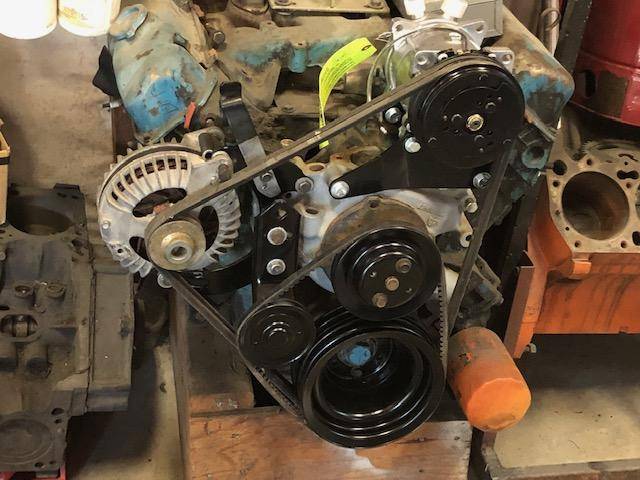

Sorry for these smaller pictures but here is with the P/S pump. These were a 3 belt setup using a 2 groove fan pulley. I didn't go this route because I thought that the fan pulley didn't have enough belt contact and might slip.

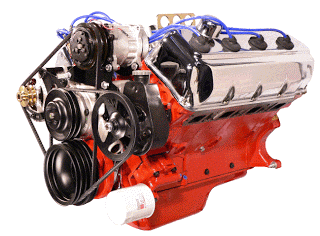

ALL A/C setups use a 4 groove crank pulley as far as I have seen.

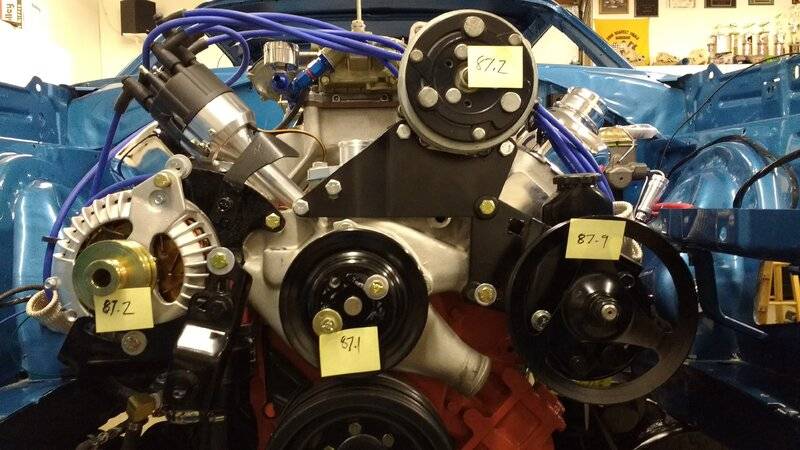

I used the factory set up like the above for my Vintage air. I didn't like their bolt on crank pulley. Plus the OEM set up has a smaller water pump pulley.
Sticky notes were when I was lining everything up vertically, My final was all within .5 degree of vertical. I highly recommend doing this on the engine stand if you can, it's was easier!

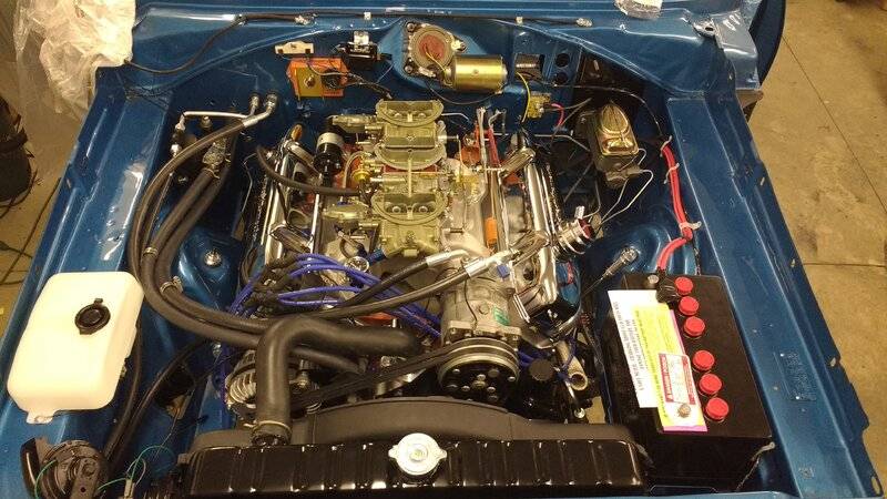

This help's a lot. Appreciate the pic's and response to my question. Thanks guy's. Sorry no the engine is in the car. But no grill on the front yet or radiator in the car. So should be easy to get too. I do need to check what classic air sent me. All I did was mount the box under the dash area in the car and run all the wiring and duct work. So now into the engine bay and trying to get every thing done under their. Thank you again. Been a grate help. blue69runner.

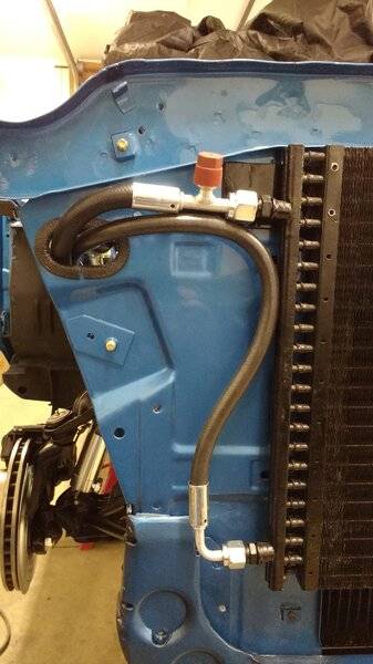

I also had the add on pulley, but I switched to the factory 4 grove pulley. Also I called them about a different upper bracket for the compressor which they had. Don't be afraid to call them if you have questions. They were very helpful. I also rerouted the hoses as I didn't like the routing over the battery.
