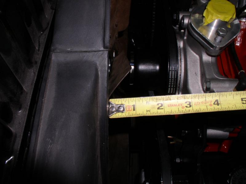

I'm to the point on my 69 Charger R/T non A/C car to figure out what to use for a fan blade. My options are a fixed blade with a 1.24" spacer which has plenty of clearance and is centered in the shroud. This setup fits very nice.
Or, what I think would have come on the car. I have an original blade that takes the clutch. I bought a Hayden 2747 which is listed for this car and bolted it together to check fitment. The blade seems to be fairly close to centered in the shroud, but what makes me nervous is there is only 7/16" between the front of the clutch and the radiator. Is this normal? Anybody else running this setup and is it worth the extra 10 or so hp. for a chance it could go into the radiator?

So are you guys saying that 7/16" is enough clearance? I have read a lot of guys are using a Hayden 2765 which is for a Jaguar, but fits our Mopars. It gives more clearance but doesn't last long because it is designed for a lighter fan blade.
Its the blades you gotta worry about, the clutch aint going anywhere. You got heck of a lot more room than me!
Agreed, the blades are what you have to worry about. If you remember in my thread my setup looks just like that, I've ran it quite a bit with zero problems. The clutch would have to completely come apart before it would be a problem.

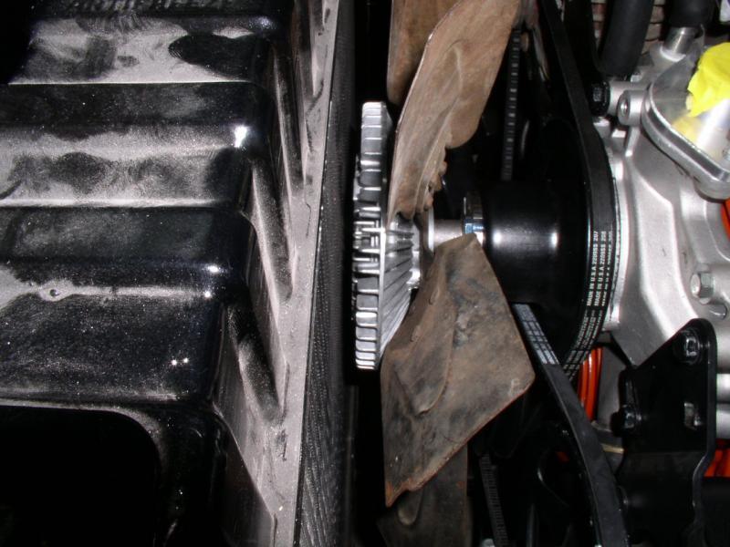

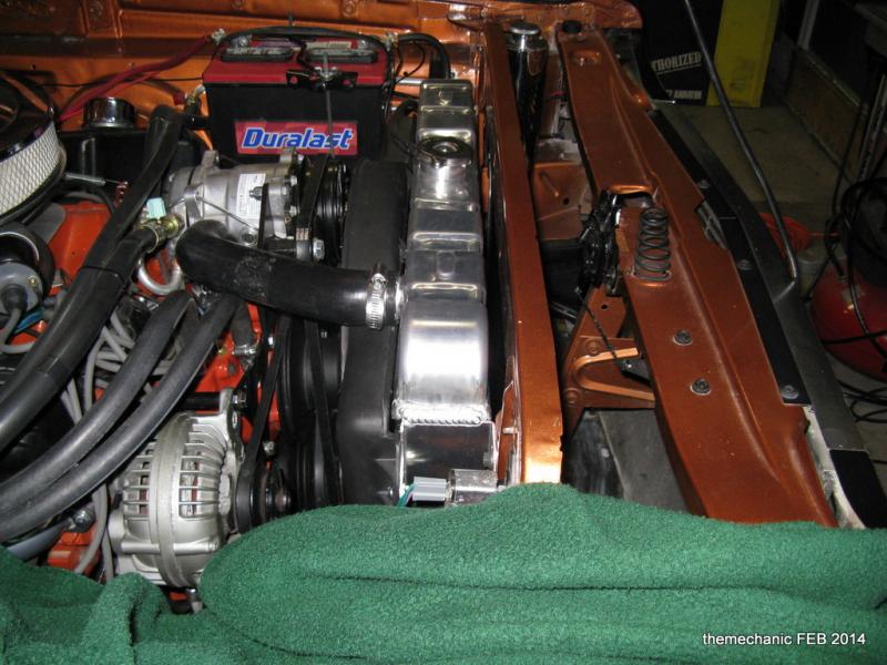

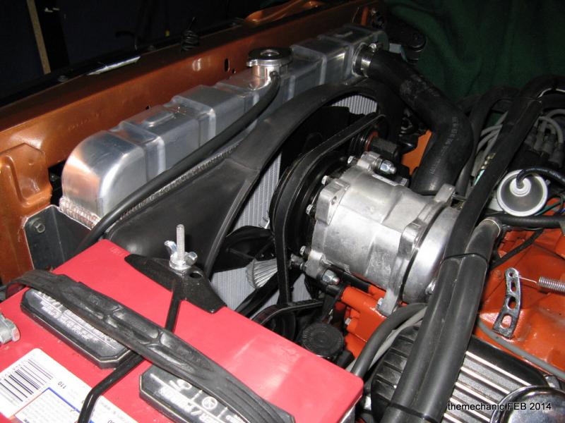

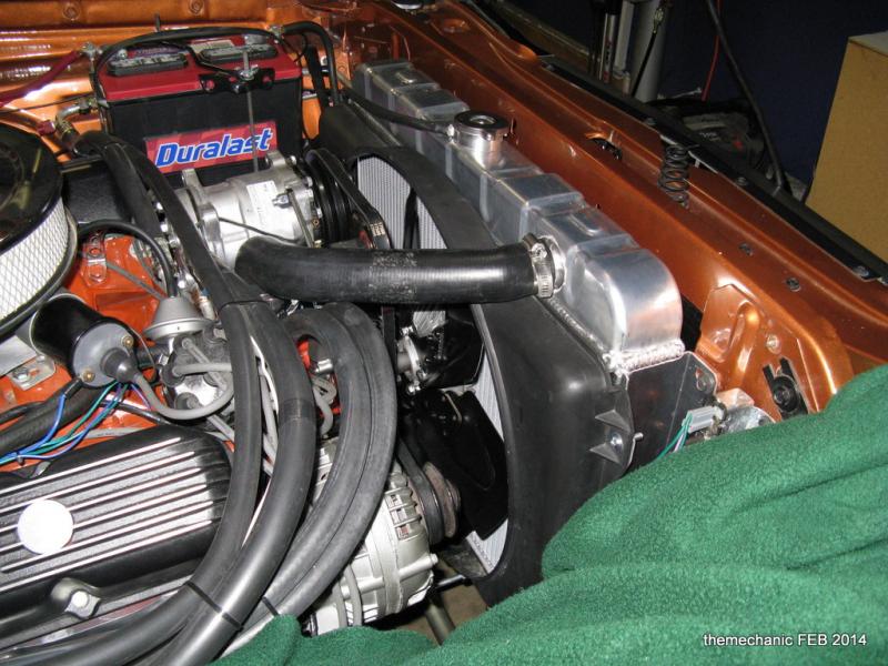

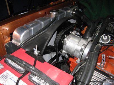

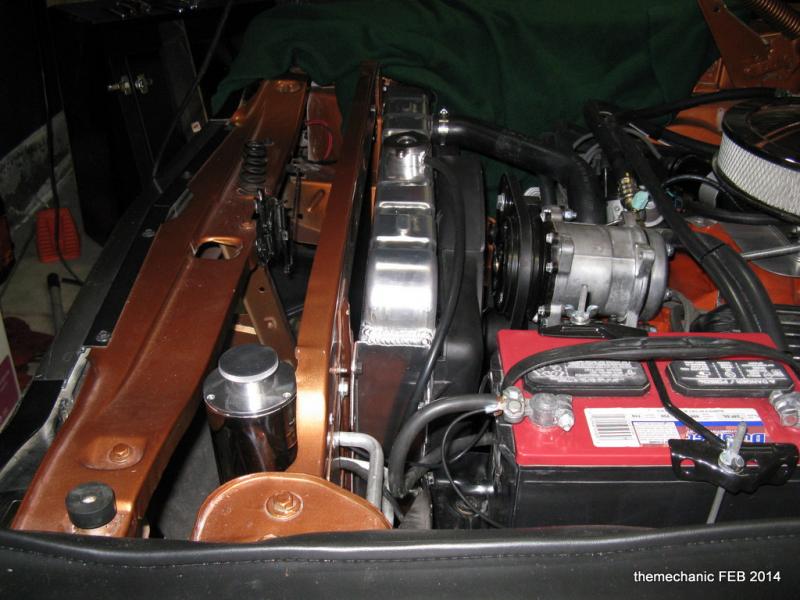

My Coronet uses that clutch and a 7-blade fan. The clutch sits close to the radiator like yours. See photo.
US Radiator Installed 9-29-13.jpgUS Radiator Installed 9-29-014.jpgUS Radiator Installed 9-29-015.jpgUS Radiator Installed 9-29-016.jpg
Looks normal too me. The clutch needs to be close to the radiator so it can get temp reading of the rad and know when to engage. The blades should be centered on the shroud edge.
I've been running the viscous fan with clutch for decades. Best setup.

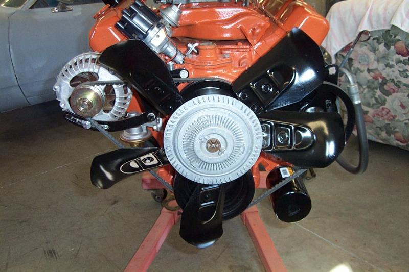

Sounds like I was worrying for nothing then. For some reason I thought there should be a little more space in there.
I think that's normal. I went through this a few months ago as well. Just bolt it up.
They make shorter shafted clutch fans if you're really worried about it.
