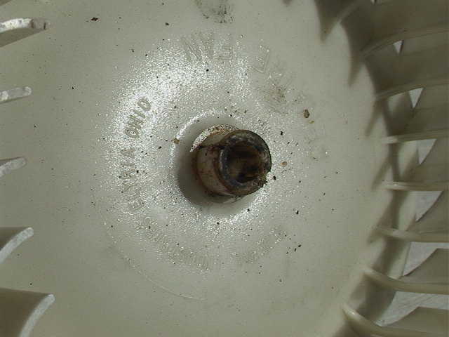

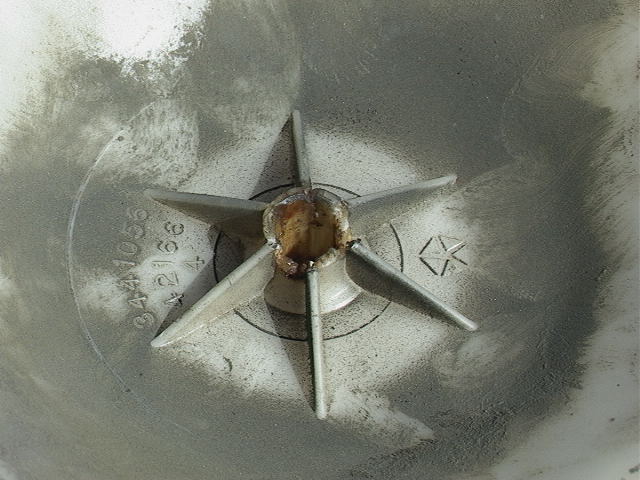

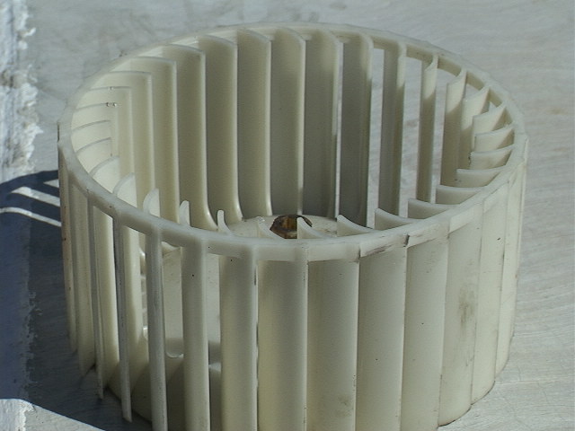

It's another one step forward/two steps back today in Mopar Land. Pulled the plastic squirrel cage off the heater motor blower during my heater box rebuild. It was stuck a little, so used some WD-40. Well, it finally came off but tiny bits and pieces of the plastic center hub went flying. It seems the plastic hub was old/hard/brittle and could not withstand my noble efforts. The sad thing is the blades were just fine and I could have left it alone (to fail at a later date?).
A quick internet search found nothing with respect to the squirrel cage itself (measures 5 1/2 inches in diamater and either 2 7/8 or 2 15/16 inches tall). Did not find anything new or used that seemed to match a complete blower motor with squirrel cage either. What does everyone else do in a case like this (heater delete, HaHa)? Thank you.

Looks like the one on Ebay has the fins reversed and/or is mounted reverse from mine, which I believe means it has an opposite rotation motor compared to mine. Might just epoxy the shaft and squirrel cage together and hope for the best.
If I were you, I'd take it to an HVAC supply house like Graingers, United refrigeration, etc. it's just a hamster wheel, anything with a blower has one just like it.

Mine was broken as well on my 74 RR non AC box. From what I could find the AC blower motor runs the opposite direction from a non AC motor. I came up with a universal metal wheel that was same dimensions as my old one. If you have a non AC heater box LMK and I can get you the part number for wheel.
The part number I used was a 35604 Four Seasons(Murray is same company). I'm 99% certain it will fit your box as well.
Hope this helps.
