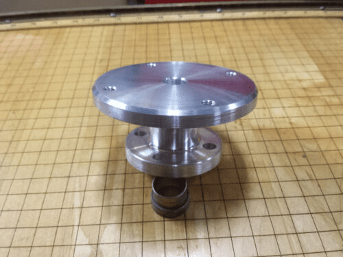

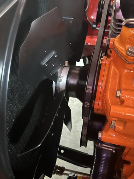

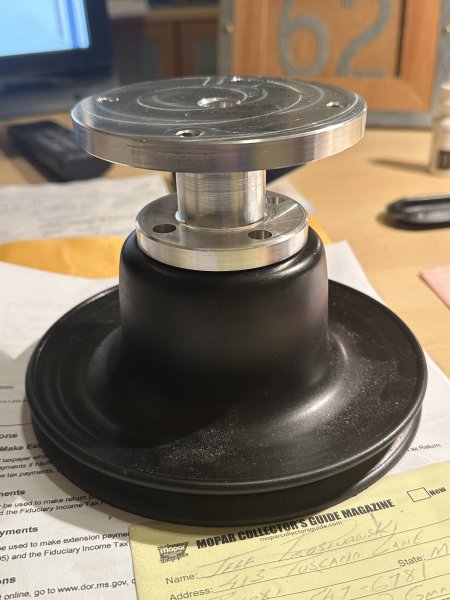

Before you go through all that trouble try this handy item. Just over size the through holes on the small end to fit your pulley and voila! You can use your factory fan blade and it puts it approx. 3/4 inch form your radiator core, right where you want to be. It works great! I use something similar on my 63. I had mine made to look more like a factory spacer, but I'm a bit picky! LOL. Let's me use the correct 7 blade max wedge fan and a 4 core super cooling radiator from Glen Ray. Let me know if you need more info.

View attachment 1848171View attachment 1848179View attachment 1848177
  • Fan Hole Bolt Circle (In): 3.25 Inch
  • Fan Mount Diameter (In): 2.62 Inch
  • Fan Mount Height (In): 1.625 Inch
  • Flange Diameter (In): 2.600 Inch
  • Number Of Bolt Holes: 4
  • Bolt Hole Circle 1.969 (50mm) Change to 2.06 or one drill size up on all four holes.
  • Overall Diameter (In): 4.00 Inch
  • Overall Height (In): 2.00 Inch
  • Pilot Depth (In): .625 Inch
  • Pilot Diameter (In): 0.630 Inch
