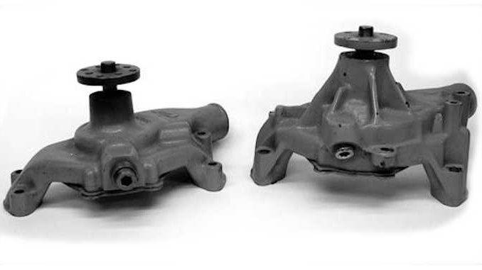

The shaft coming off the front of the water pump. Sort of like this:
There's dozens of different size/shaped pulleys depending on accessories, as Darter6 said.
I wouldn't count on re-using the pulley, even if it will physically bolt onto your big block water pump. You 'should' be okay on the fan though.

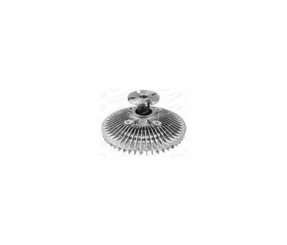

I was referring to the viscous fan clutch fans
I forgot about the simple fan/spacer combo
But as Suregrip stated each water pump combo requires a matching set up

No worries, mine is just a regular fan. I believe the clutch fan was for heavy duty cooling packages?
yes mostly
It also used in performance applications because it doesn't eat as much horsepower
I bought one years ago from Mopar Performance and it hit the radiator on my big block
This is how I learned about the different shaft lengths and the first thing that came to mind when I read your question
