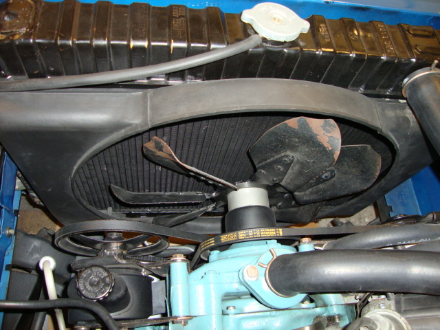

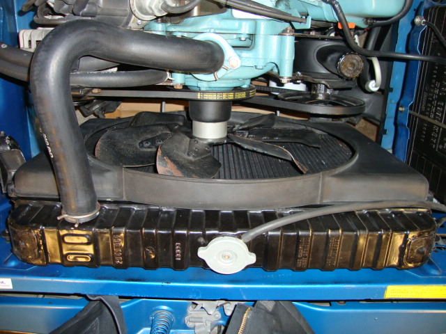

a stock plastic one has worked great for me! (26" rad). found it on flea-bay.
(Stock MoPar rad; was re-built 2 years ago, w/ a 3-core)
stock shroud, 7-blade (hemi :icon_rolleyes:) mechanical fan, new 16lb cap and a little bit of water-wetter in the rad; good as gold. :toothy12:
stopped her from overheatin', even in traffic.
at a crawl, she doesn't get higher than 195* :hello2:

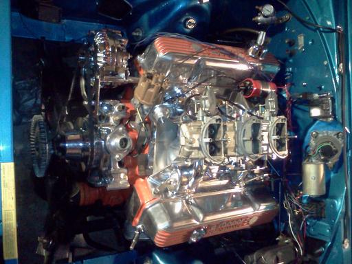

I have my old shroud that would probably work but I went crazy polishing all the aluminum, pulleys, alternator etc.. and it might not look right with all that glitter in there.
Anyone know a cheaper alternative? I've seen them go for $125, a cheap boneyard shroud that is proven to fit would be great!
There's a 7 blade fan and Griffin Aluminum radiator in there now because the clutch fan didn't fit anymore.
