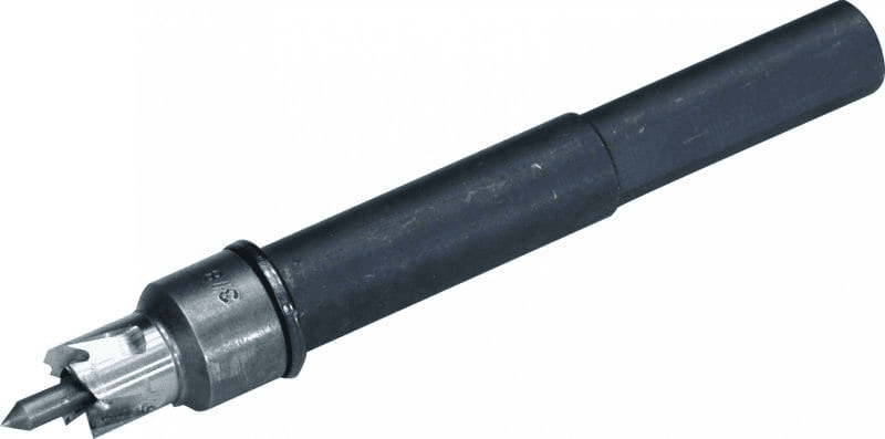

There are actual correct spot-weld drill bits available that make a countersunk hole on the first panel, and a much smaller centre-drill type hole on the back - typically 1/8"
Just enough to get release between the panels.
I used those when I replaced the front stub on Jigsaw.

It actually looks like a Uni-bit or Cobra bit which I have bunch of. They do drill fast.
I used the Blair Rotabroach in 5/16" and 3/8"

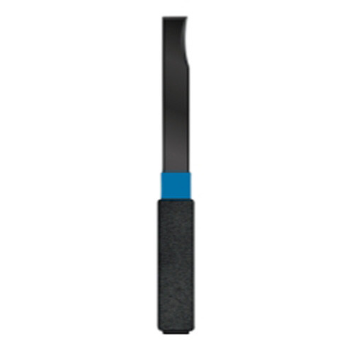

Also the seam buster blades for where a drill won't work and also cutoff wheels..
RotoBroach on the keeper and whatever is fastest on the donor.
