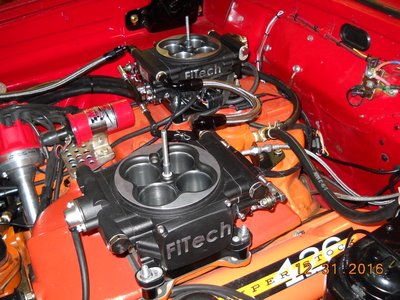

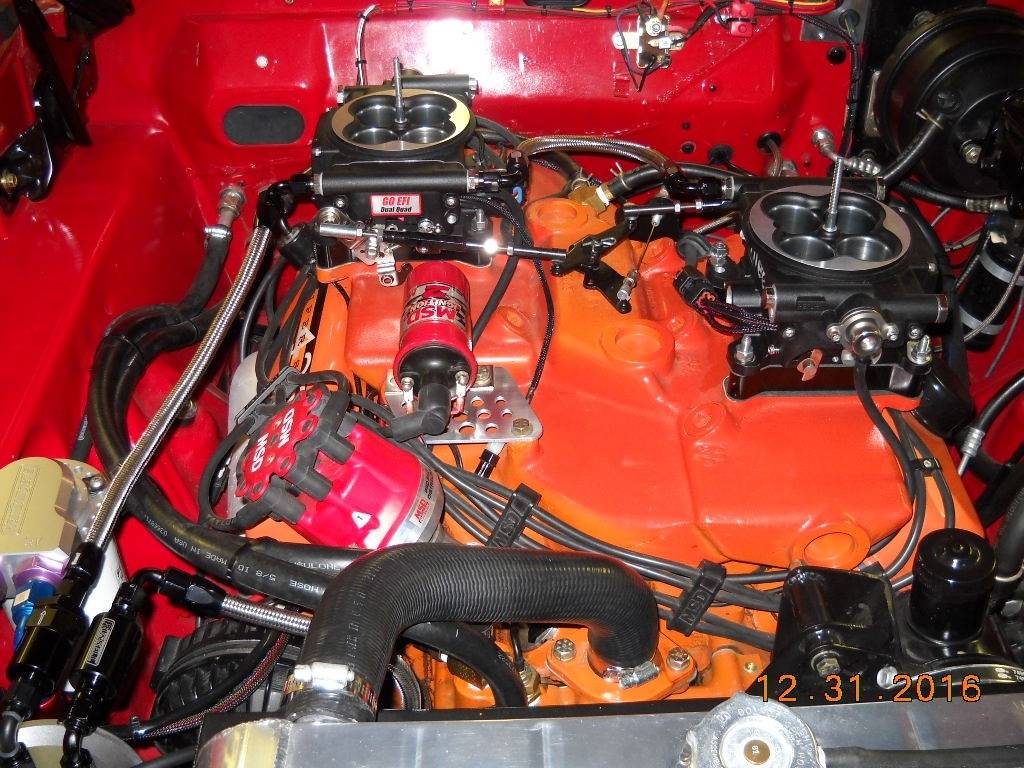

A system in daily use...
I'm thinking that Emails are somewhat like Cell Phones- Dropped calls, missed calls, blah, blah, blah. I will call you as I now have your number. I'm ready to purchase an EFI Setup for my Cross Ram B Engine. I have read most of your articles. Your opinionated arguments are what brought me to you. When a man opens his mouth and blows out factual information- I listen. When a man talks ****- I know it. You Sir, seem to have a useful knowledge. My Engine Builder warned me against using FITech.
He has customers who are quite unhappy about warranty claims and time involved. Warranty? On a brand new part? WTF?
I want Complete Fuel Injection Components for my healthy(.0.40 Over, Forged Internals, Reworked 915 Heads, SS Valves Lunati Voodoo Cam) '67 383HP using a Cross Ram. Total Price is not my main concern. Best Bang for The Buck and hassle free installation are. I'm using a custom built aluminum fuel tank that eliminated the spare tire well. I have not yet cut a hole for a sump/sending unit/fuel pump. I do have two 8-AN outlets at the bottom right front of fuel tank.
