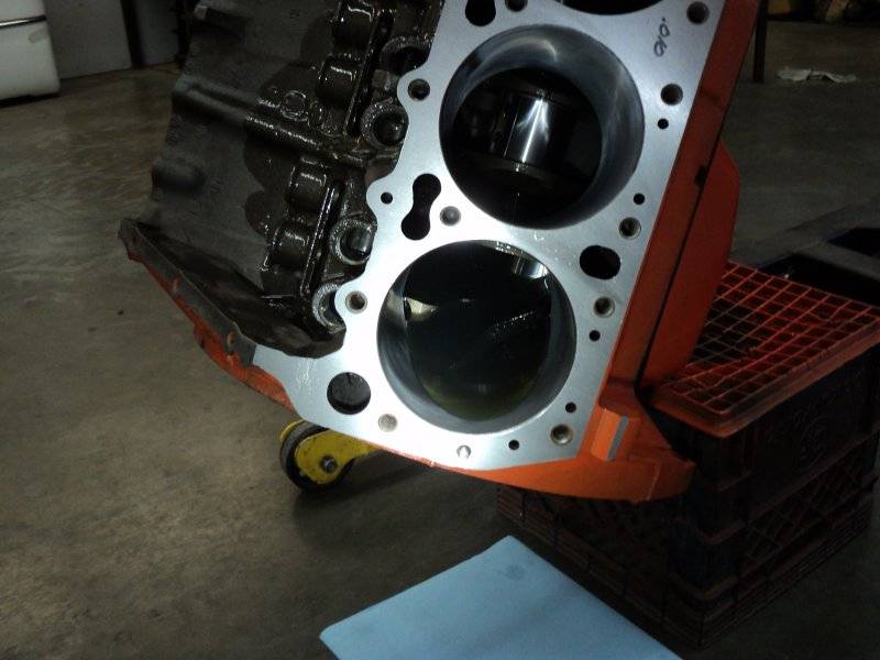

Well I built this engine 4 years ago and it has leaked from day one. The motor doesn’t even have 500 miles on it but that’s another story. Me and the engine builder talked and he guaranteed it wasn’t the crank seal but the factory retainer and I agreed also so I didn’t take it out. I put a Mancini rear in it Friday evening and it went in beautifully. Sunday morning i put 6 quarts of 0w20 in it. Hooked it to an engine puller and leaned the motor way back putting the oil against all of the rear. Well it leaked. It Didn’t leak out the sides or the bottom of the retainer. It looked like the crankshaft block seal was leaking. It was oil soaked bad and it pushed out with little resistance. Now I will add, he didn’t have it clocked but I had the seals glued together with Right Stuff and he had used a rubber felcro seal with factory retainer.

My Mancini was perfect. I did use the 2 small o-ring side seals but I used Black Right Stuff on everything. I don’t like Ultra Grey, never did, it’s not made for oil but Ultra black is. It did not leak on the sides or the bottom part of the retainer. Leaning the motor back filled with 0w20 trick works. I also turned the crank a few times. I had the seals glued together and it was leaking at the block crank seal. I easily pushed it out and it was soaked with oil. I’m thinking about just using Right Stuff instead of the oil rings this time.

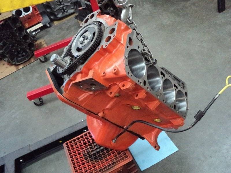

Yep.... we 'hang' every BB Mopar engine we assemble here with just the Crank/Seal installed and completely submerged in Oil for a few hours before proceeding with the rest of the assembly.
If it's gonna leak ?.... we want to know BEFORE we run it on the Dyno !
Forget the side seals, we use the side to side 'play' in the retainer and move/drag the seal half side that doesn't seal against the crank over into contact(BB Mopars are notorious for that).... then tighten the Bolts and just silicon the sides up.
Factory retainers, stock seals.... never an issue.

0w20 is the oil I use to submerge my seals with because if any oil will find a leak 0w20 will. Are you confident enough in your process that you go ahead and install all of the gaskets on your oil pan and windage tray?

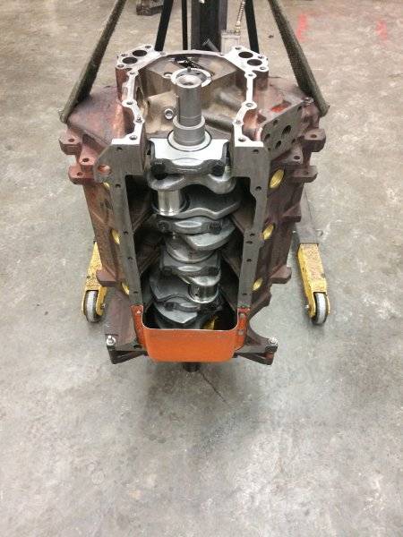

Got the Fast Fish rear main seal in this evening. I really like this set up. Double lipped, the retainer is notched out for my APR cap bolts and nuts, the inside bolt holes had plenty of play to keep the retainer center on the seal itself and the No side seals is genius. I put the seal in with the motor out without loosening the cap.This is a lot better set up than the Mancini I used the last time in my opinion. I’ll give her an oil bath tomorrow and see if she leaks or not.
Well looks like I have a clearance problem where the crank sets in the block. The oil looks like it’s bypassing in between the seal and the block retainer if that’s what you call it. Dry as a bone on the side and it’s dry on the retainer side. I pulled the fast fish seal out and put a 2 piece in. Glued it together on both sides, let it dry amd clocked it 6 and 12 and got the same
Results. The oil is bypassing the upper seal. The only thing I can do now I guess is put a rope seal in it without pulling the crank.
