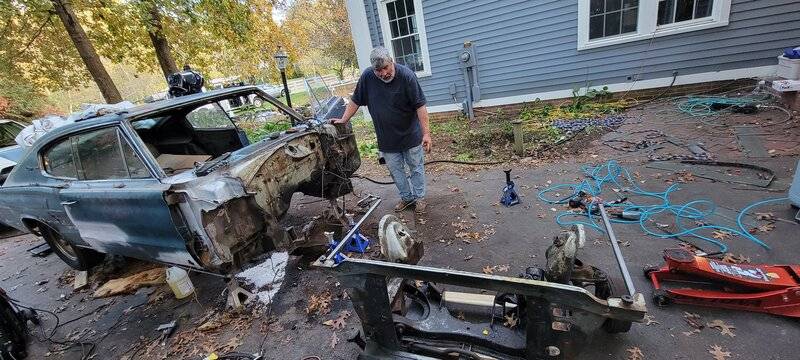

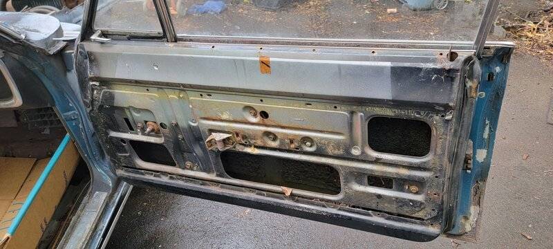

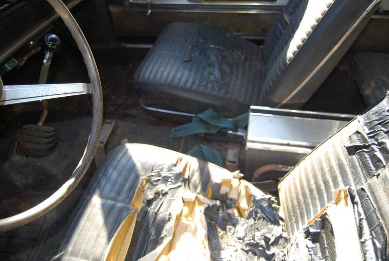

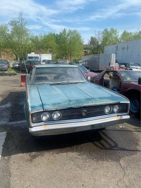

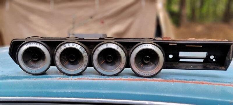

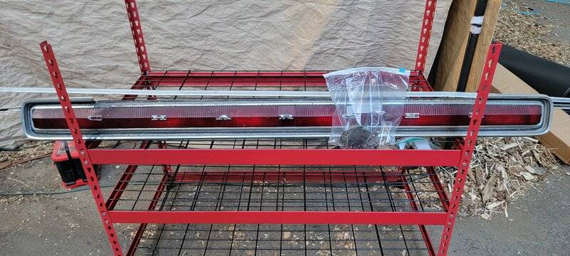

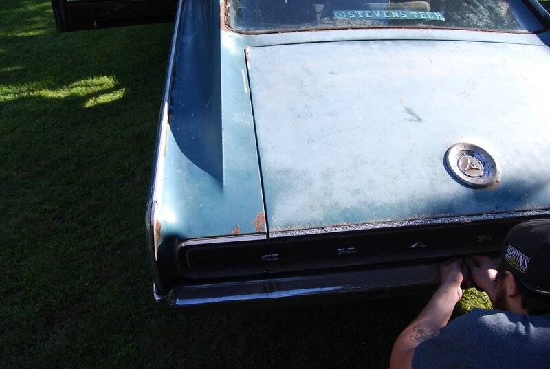

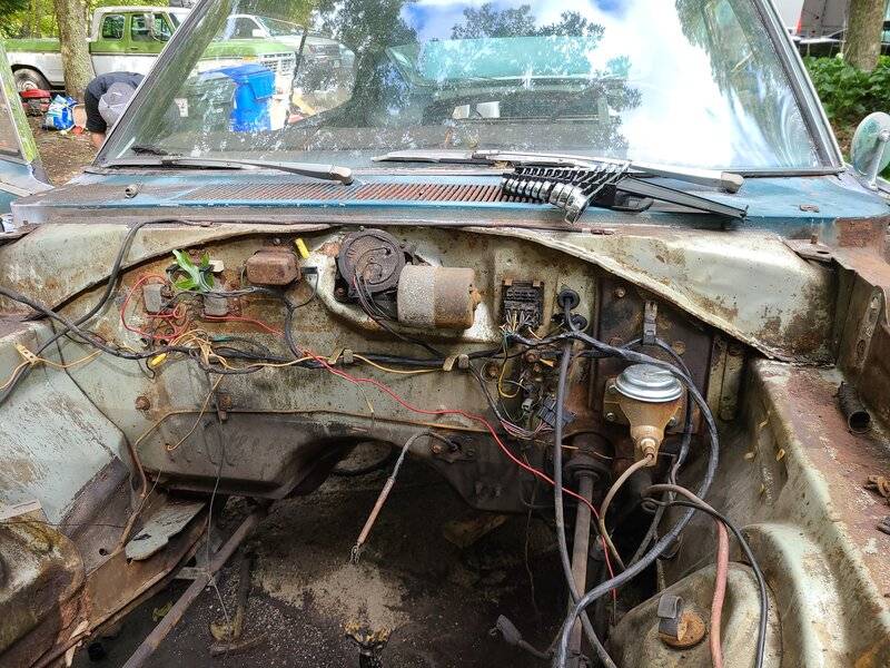

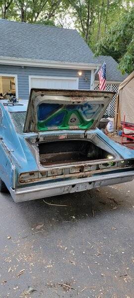

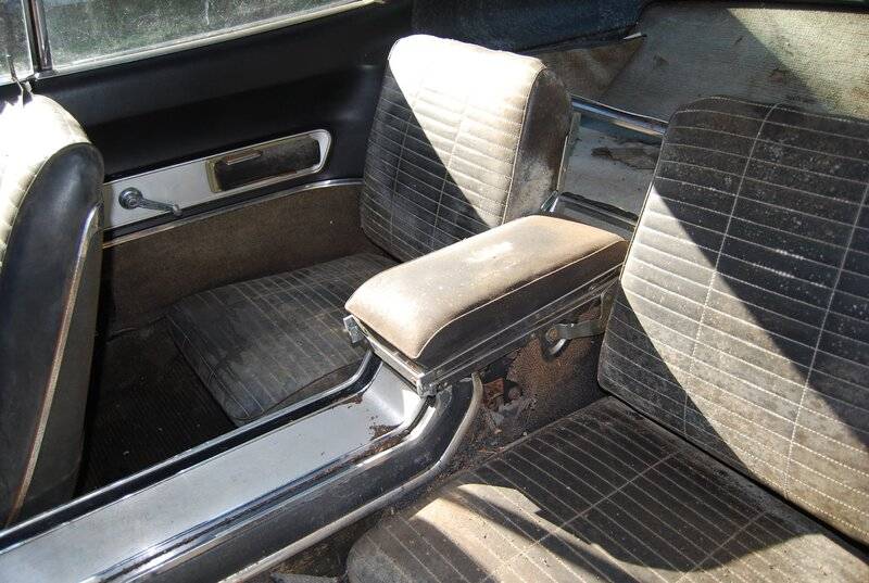

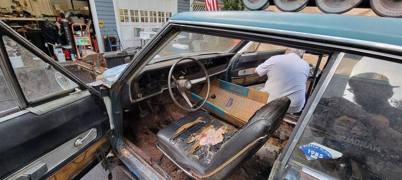

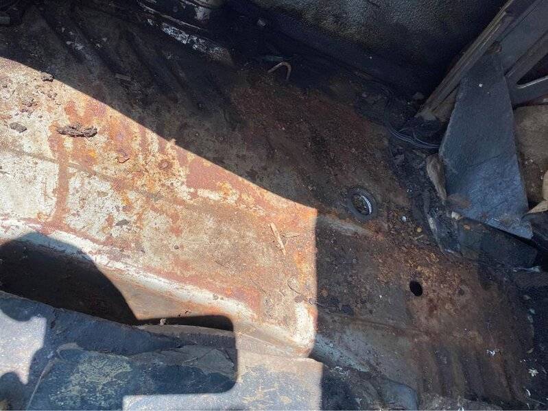

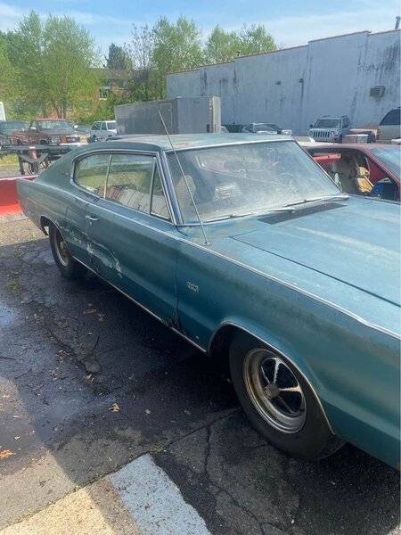

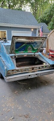

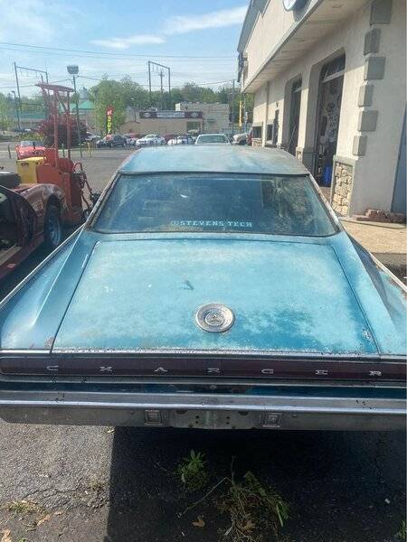

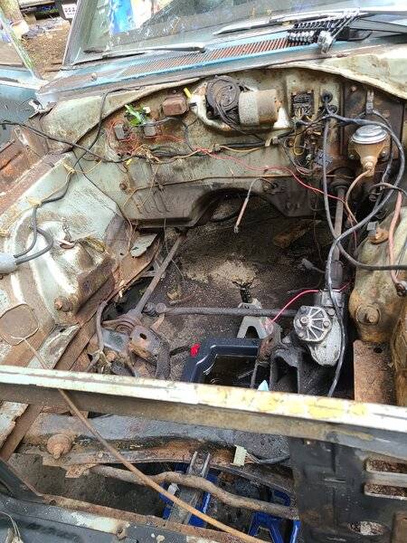

My Dad and I are restoring a 1966 Dodge Charger 383 4spd we picked up last month and Ill be documenting all the restoration here in this thread!
Hi guys/ and girls! My names Kyle Welch and I recently purchased a 1966 Charger 383, all numbers matching. My dad and I are currently in the process of restoring it and this site has been so helpful already that I decided to create an account here to document and ask questions from you all!

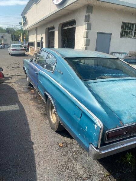

My Dad's first car ever was a 1966 Charger 383 4 barrel 4spd, so we went out and found this one. Its definitely ROUGH, but fixable.
201085024_10221562958117403_1274394249547042867_n.jpg 201221645_10221562957677392_5570397715254264329_n.jpg 201247830_10221562957597390_8999288210369306857_n.jpg 201593022_10221562958237406_3453171460690926305_n.jpg

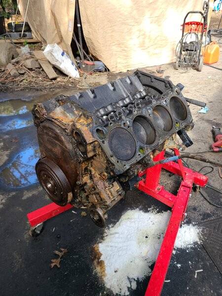

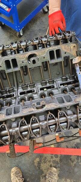

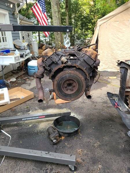

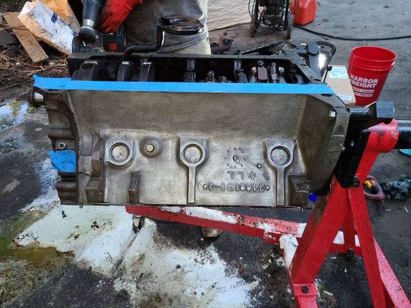

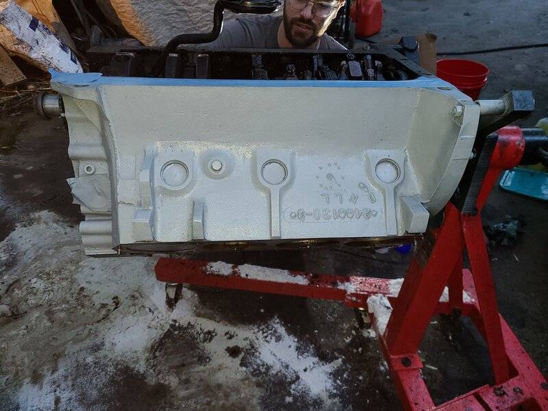

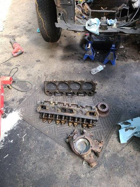

Pulled the engine out yesterday, put it on the stand and started to tear it down. Just dropped the heads off at the machine shop and are ordering a new cam and roller rockers and lifters.
20211006_145218.jpg 20211006_145224.jpg 20211006_150535.jpg 20211006_150711.jpg 20211006_150721.jpg 20211007_124714.jpg 20211007_141558.jpg 20211007_141602.jpg 20211007_175218.jpg 20211007_180137.jpg
Manual Brakes, Manual steering, 383 and a 4 speed. That car was built for hotrodding, have fun with the build, looks like a good foundation.

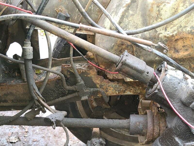

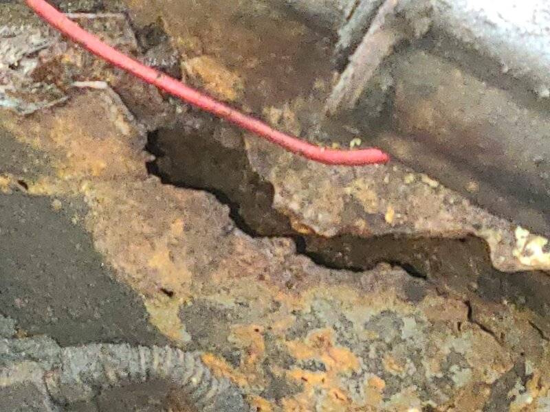

Yikes, that frame rot looks scary! Bitchin' car thou, welcome and good luck.

Keep up the hard work, besides the frame rot the car looks good. :thumbsup::drinks:

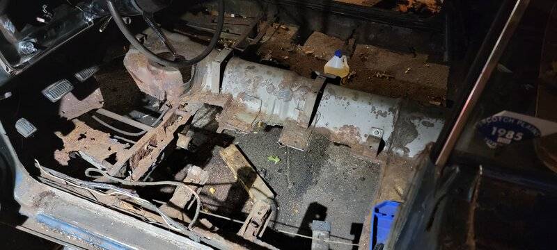

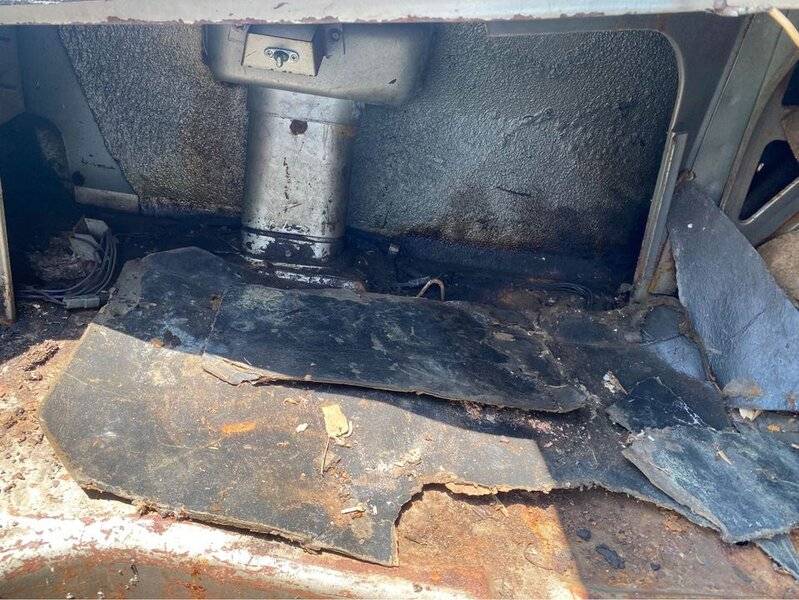

we bought all new amd frame rails, new inner fenders, new torsion bar crossmember, new firewall, and a new floorpan. Thats the next step of the process is replacing that entire front clip.

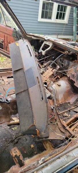

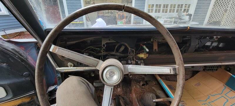

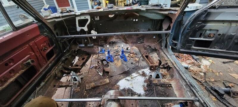

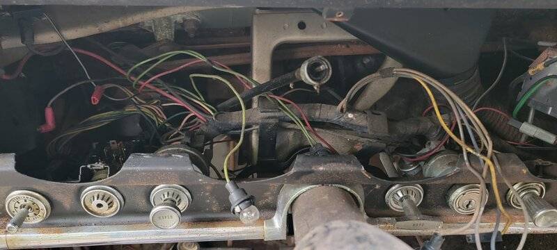

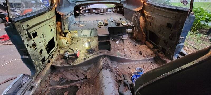

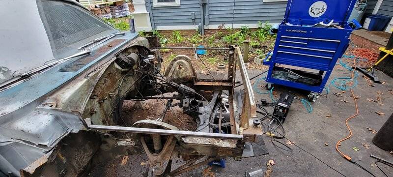

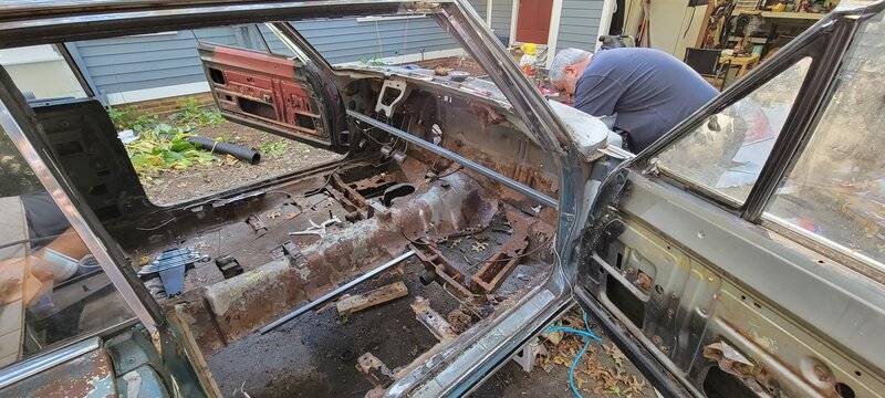

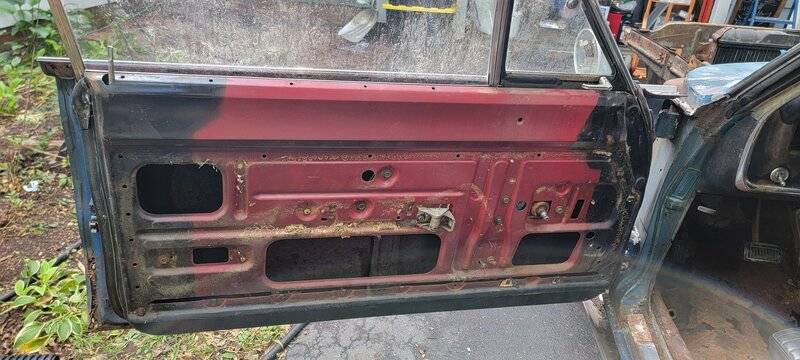

So update as of today, Ive cut the inner fenders off, removed the dash, braced the body, cut the front clip off, removed the torsion crossmember, and cut out most of the floorpan.
We sent the heads out to get cleaned up and beefed up with roller lifters and rockers, and a new camshaft is ordered. The carb was sent out to be rebuilt, and we actually found out that the one that was on the car is actually a Clinton 4299s (which was supposed to be on a 426/440 and ours is a 383) so our carb guy is looking to see if he has the matching afb for our engine, if not the 4299s is being rebuilt and put on the car.
Next is to weld new frame rails, inner fenders, torsion crossmember, and radiator support to the front, patch the holes in the firewall, and start to reassemble.

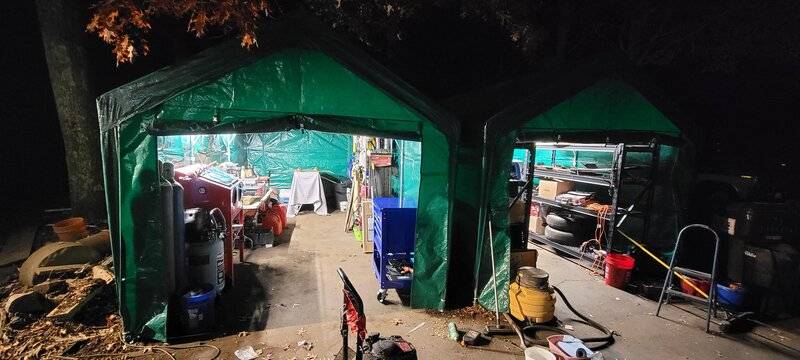

We also bought two new carports to keep all the tools and parts closer to the workspace
