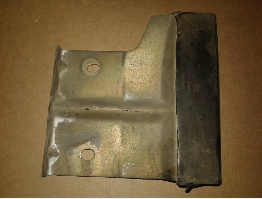

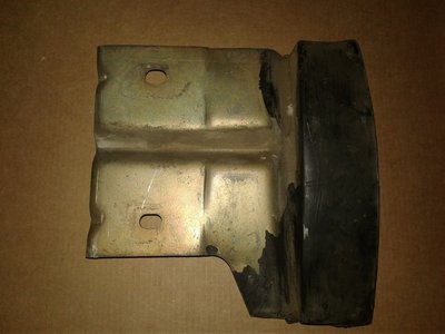

do you need the impact bumpers that bolted to the side of the fender and the bracket that went to the bumper or are they better off leaving them off or not needed? Its for a 1973 charger I am putting back together..
They help keep the corners of the bumper positioned with the fenders. If you have them I would put them back on.
The Engineers have them there for a reason why not keep what was with the car when it was designed? I have mine on the car.
Do you need them, prolly not, but would I replace them ... yes.
I'd replace them as well as 73ege said, they are there for a reason. Hopefully you would never need them but the damage that would incur would most likely be more significant with out them. From my first 73 back in the day, I can attest to that.
I saw them many times at Carlisle this weekend. Not hard to find.
I think they are or will be reproducing the inserts so at least you won't have a big gap. You can also swap to the 71/72 bumper brackets to suck everything in.
I have a nice driver's side one if you decide to go with them.

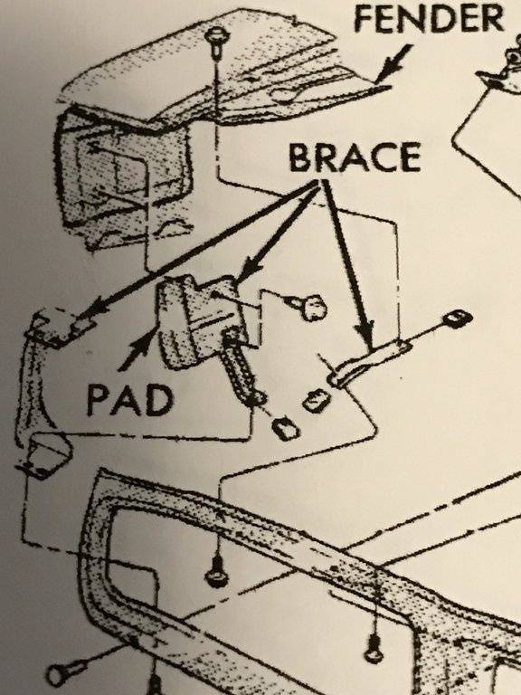

They are called: Impact Pads included in the entire bumper system working together adds up to the total spec to absorb a miner straight on square crash and to pass the 5mph bumper standards for 1973
