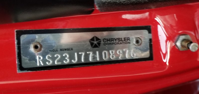

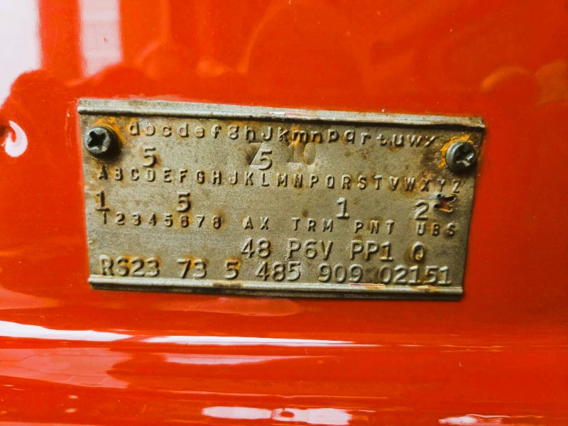

Can anyone help me decode this fender tag? And, do the stampings on the various parts tell whether they are original to the car? Thanks in advance. I've spent hours searching..

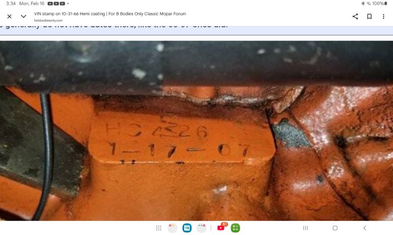

1967’s don’t have vin or any numbers on block to say it was exactly the original motor. There’s stampings underneath block near bellhousing that can tell the assembly date.
You need a Chrysler Historical report to tie the fender tag to the body. Or the built sheet.
The last numbers on that fender tag are the S.O. (Shipping Order) Numbers. Those should match stamping on radiator support and under trunk weatherstripping stamping.

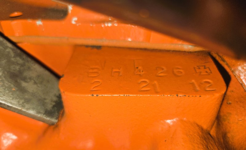

B = 1966 H= Hemi 426 Maltese cross is undersize crank journals. 2 and 21 would be Feb 21st build date... in '66. WT is Water test, but the 12 is a throw off....
Engine is for a '66 car.
I thought I heard that Mopar made so many 66 blocks that they carried over into 67?
VERY possible, but the B is for '66. Still don't know what the 12 denotes.
They cast a LOT of blocks in '66, but did they build out that many ahead of time that would have been prestamped "B" ?
The letter B stamped on top says it was installed new in a1966 vehicle.
Just like any other engine from 1966, letter B on them.
1967 would be a C
The 12 meant 12th engine assembled on 2-21-1966

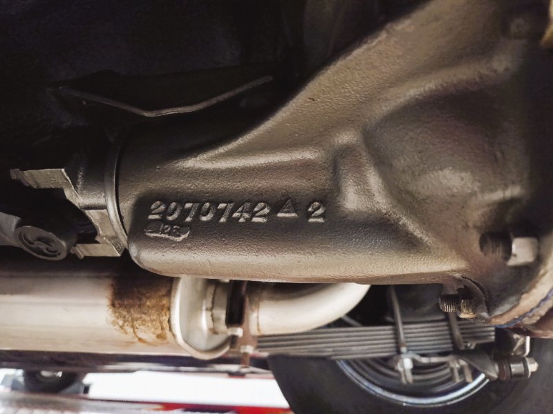

The auto trans picture shows a VIN pad, which did not appear until the 1969 model year. The part number stamped just above the pan on the driver's side will tell you what you have. The body code numbers will be 77 909 02151 if the fender tag is original to your car. The rear end has the correct casting number, with what looks like the proper 1330 U joint. I also agree with the above stated, 66 model year hemi.
Thanks. The 12 denotes that it was the 12th engine built of Feb 21st in 1966. I found out that no Hemi engines were built in 1967 since so many were built in 1966. Plymouth used the 1966 engines in the 1967 cars. They didn't start building Hemi motor again until 1968 since they built so many in 66. They had plenty left over for the 1967 cars.

Thank you so much. I have the build sheet. It's hard to read but I'll see if I can find the number sequence that you are referring to. I appreciate the input.
Thank you for the input. I'll look for the sequence of numbers and see what I can find. I read an article that said that the 66 blocks were used in the 67 cars. I'll call Galen and see if he can verify that and will let you all know, assuming he returns my call...
Indeed that is true, but I would suspect they got stamped C. Lots of guys that can confirm or deny. More than a handful of '67 Hemi cars owned here..

I have seen several 67 hemis with a C stamped on the pad. I don't think they cast any blocks in 67, but they certainly built them in 67.
