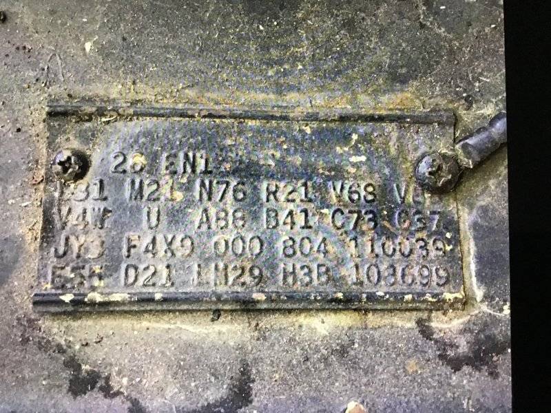

Hello from an avid E-Body enthusiast. I currently have a 1974 Dodge Challenger Rallye, beautiful car!!
Having said that, I've always been a Mopar guy. I've had Chargers, Challengers, Darts, a Duster, a Volare, and a Power Wagon.
I'm currently looking at a 1973 Dodge Dart Sport, that is a Factory 340 car with a factory 4-speed.
I asked the gentleman who is selling the car to take a picture of the fender tag, as I wanted to decode it. It verifies that it is a 340 car (I'll have to verify it's an actual 340 upon visual inspection) and also a factory 4-speed (which I love, my Challenger is a factory 4-speed with the Pistol Grip shifter).
However, something that *bothered* me was that in the decode, it refers to the car as a "Dodge Dart/Demon".
I thought the Demon moniker was dropped after 1973 and switched to "Sport"?
Anything else I should beware of...any advice from the experts? I know quite a bit about the E-body cars, and I know enough to ask the experts when I dont' know. So I'm coming right to the experts here. Thanks for any help!
Here is the decode BTW, I'm not sure all the codes were right because a few of the letters/numbers were hard to see in a phone pic, but I think the vast majority are accurate.
LM29:
Dodge Dart,Demon
Medium
2 Door Sports Hardtop
H3B: 340 240HP(net) 1-4BBL 8 CYL
1973
Dodge Main, Hamtramck, MI, USA
103699: Sequence number
E55: 340 cid 4 barrel V8 275hp
D21: 4 Speed Manual Transmission
JI3: Unknown Exterior Color
F4X9: Trim - Luxury, Vinyl Split Bench Seat, Black
000: Full Door Panels
804: Build Date: August 04
110039: Order number
V4W: Unknown Top Color
U: USA Specifications
A88: Interior Decor Group
B41: Front Disc Brakes w/Standard 10in RR Drum
C73: 69 only Fold Down Rear Seat
G37L31: Unknown
L31: Hood/Fender Mounted Turn Signals
M21: Roof drip rail moldings
N76: Coolant Recovery System
R21: AM/FM Radio (5 1/2 Watts)
V68: Longitudinal Stripes, Deleted
V86: Tranverse Stripes, Unknown color
26: 26in Radiator
EN1: End of Sales Codes
The M code cover all Darts from 69-74 including Swinger, Demon, Sport. So what is the question really ?:moparsmiley:
I guess I was wondering why the fender tag would say "Dodge Dart/Demon" and not something like "Dodge Dart/Sport"...etc.
Beyond that, I was wondering if the fender tag codes looked OK, if there was anything specific I should look for, be leery of, etc...that's specific to the B-Body Darts, etc.
The fender tag does not say Dodge Dart, Demon, the decoder that was used did. LM29H3 is a 73 Dart Sport 340 which is an A-body.
Neat car. Tag looks good. 340 4-speed = fun!

On line decoders, generally, suck as they cannot account for the year to year changes, like the one you just pointed out.

The JI3 you have wrote down as the unknown exterior color looks like it should be JY3. I would image Y3 in 73 would be close to Y3 in 1970 which was a yellow gold/mustard color.

JY3 (Light Gold) is the actual color code according to the tag photos. V4W is a white vinyl roof of some kind, probably half or 3/4 or whatever they put on Dart Sports in 73. I'd confirm the engine is actually a 340 and not a 318 or 360. You say you've owned several Mopars including Chargers, Darts and a Duster, yet you don't know the difference between an A and B body?
Get the car up on a rack and check for rust with a strong light and an ice pick, especially if the underside has old undercoating or is greasy/dirty. Rust means $$$. I would get more information on the difference on the different A-body models before I spent any money. Why not go over to FABO and check in with them. They could give you more precise info on these cars than you will probably get here. Good luck.
