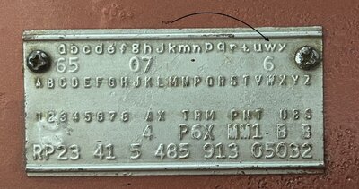

What would Y6 signify on a 66 fender tag? This is under the capital Y on the second row. Also w6 on the top row - a 6 under the small "w"
So far, none of the fender tag decoding sites have addressed what "Y" and "w" signifies.

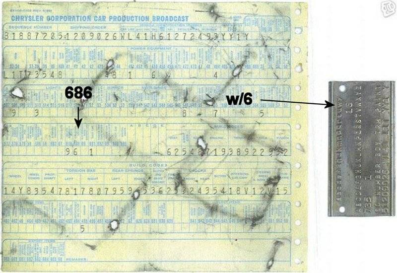

Y is roof and w is sales and delivery info

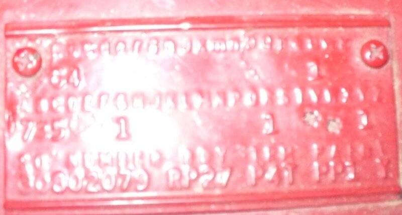

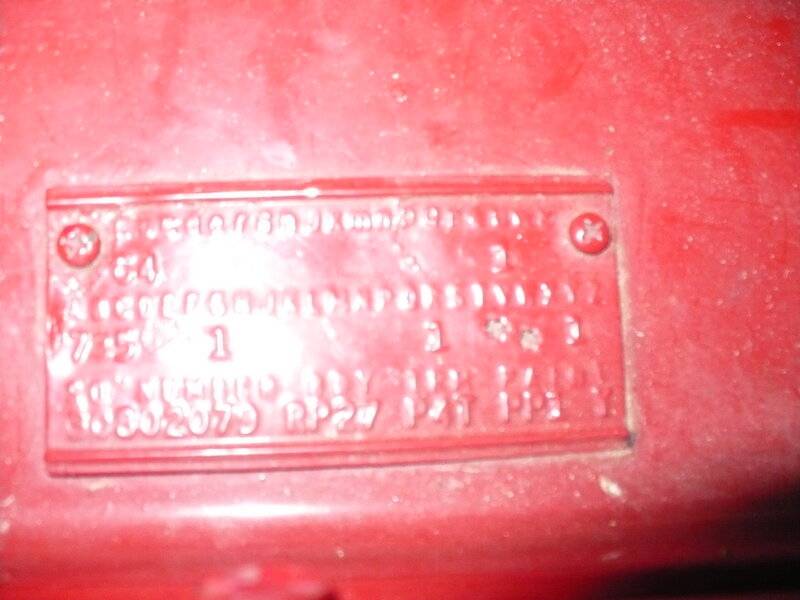

Mine has a 1 under the Y. Convertible Black top??

I’m using the Dodge Charger site as it seems the most informative. I wonder if a 6 under “Y” is vinyl top?
Also the 66 fender tag has an 8 digit sequence shipping order number on. But this is different from the last 8 numbers of the VIN - correct? Or not correct?

Yes. Y6 is Vinyl Roof- Black. Yes, the sequence number is different than the VIN.
This is a Lynch Road assembled car so that may explain some of the issues. I did subsequently find that the so number is not the VIN on pre 69 cars.
thanks
The VIN and SO numbers are two distinct numbers in all years. They started putting both on the fender tag in 69, as well as the last eight digits of the VIN stamped into the body.

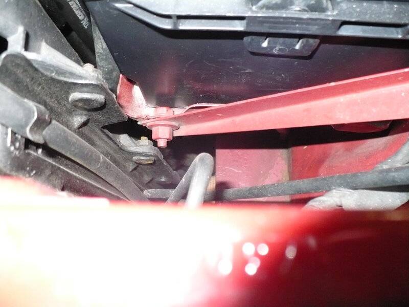

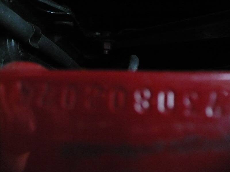

The SO is stamped on radiator support and covered by anti-freeze sticker, driver's side. Poor pic but helps with location.

Thanks Y6 is the one thing I didn't know on my 66 Satellite tag but,,, NOW I DO!! black vinyl top
