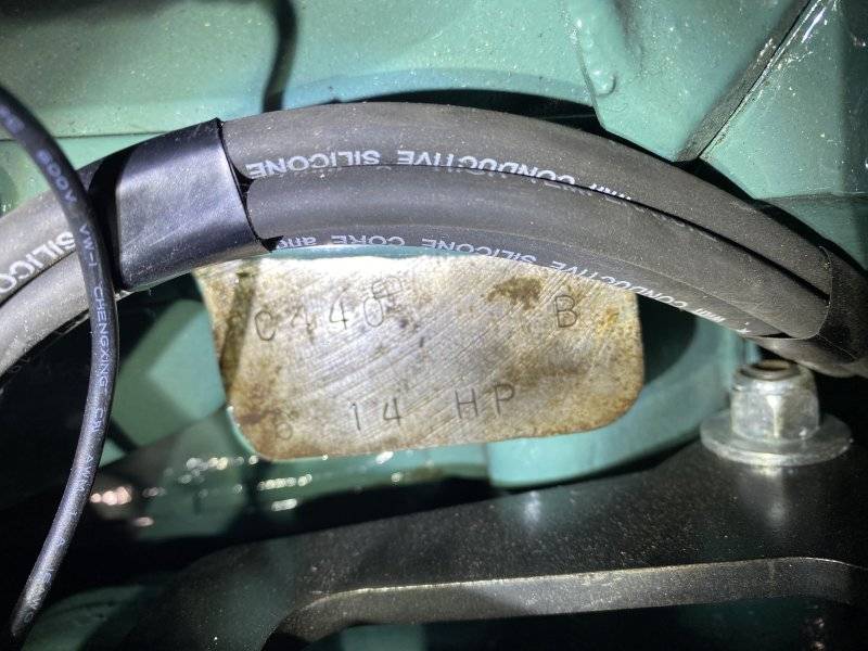

This pertains to a 67 Coronet RT. I plan on taking it to Mecum Harrisburg to see if I can move it along.

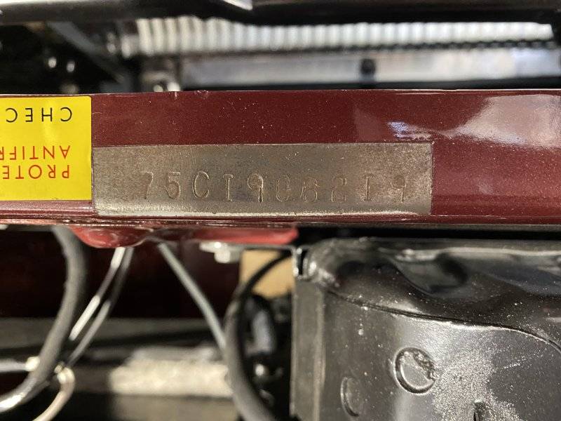

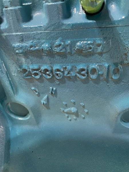

I’ve always believed it was a matching numbers drivetrain but the info on the engine tag and spd on the fender tag has me confused. Or I’m not decoding the spd correctly. I’ll post pictures of everything I’m looking at. Assembly date on engine pad says 6 14, fender tag spd is C19 (Dec 66 ?) ibm card says shipping date 12/22.
Is the engine correct for the car?
