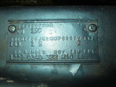

I consider myself fairly competent at decoding fender tags but I can’t find the data to decode this 64 Plymouth Belvedere that I believe is a street wedge, any help is greatly appreciated
If the fourth digit in the V.I.N. is a 1 then the car was built at lynch rd. If that is the case then the 14 under the AB is the code for a 426 street wedge and the 3 under the C is an 833 four speed.
14 under the AB = code (14), 426 1bbl, 365 hp, HP, 10.5:1 cr
3 under the C = code (343) 4 speed, A833 Floor Shift
1 under the G = code (361) Radio, Music Master economy
5 under the J = code (385) Heater, Front with Defroster
2 under the V = code (652) Vehicle Sales and Delivery (Sold Car, Expedite)
(These are if it's a Lynch Road. Codes fall in this direction)
Thanks, that all matches the car. Any idea on the upper row or the 322 M10 LL on the bottom row?
First off, make sure the fender tag belongs to your car. The body code on the rad. support should be 4 1 1227 0340. The 322 is a plymouth belvedere 8 cyl. 2 dr. hardtop. The M1Q is medium price cloth and vinyl bench seat in turquoise. LL is the paint code for dark turquoise metallic for the body and roof. The upper row, I don't have any info on.
