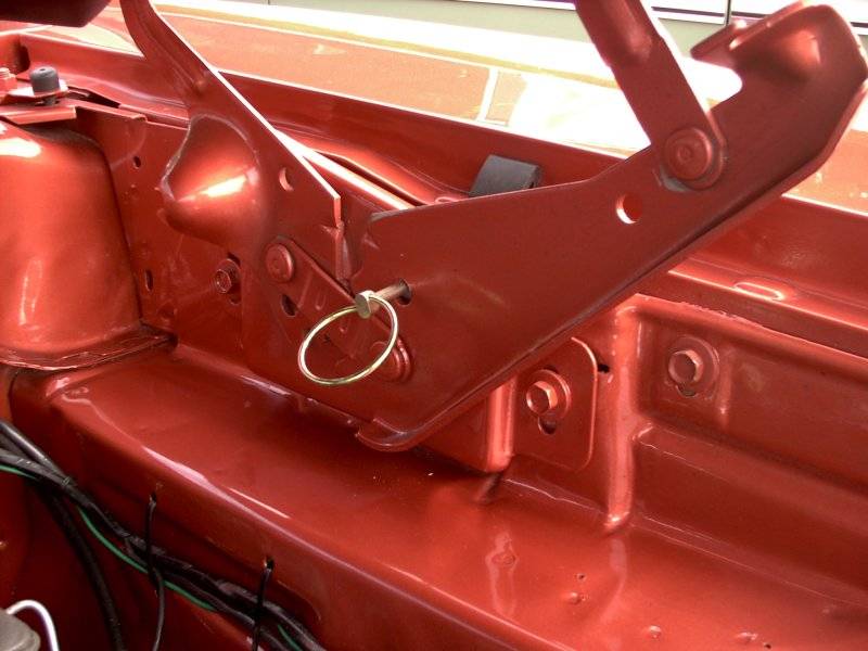

Right now I have no springs on the hinges at all. The springs do two things, they hold the hood UP and then they pull the back corners DOWN so the hood fits flush at the rear. With no springs you have to push the back down after closing the hood. HOWEVER, the springs also put tension on the hood when you're opening and closing it and I'm a little concerned they will cause the hood to crack. So right now - no springs. Attached is a photo of someone else's solution to keeping the hood up without springs.

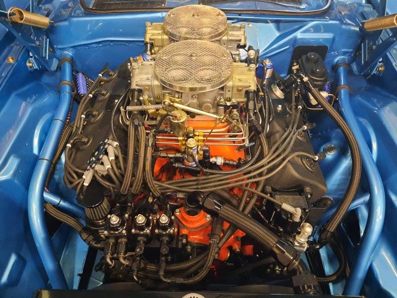

I used a Harwood 210, gold in color (medium tension) with my fiberglass Shaker hood. They also have a 200, silver in color (Light tension) and a 215, black in color (high tension). They are all still much lighter than factory springs.

Thank you....Glasstec is where he got the hood. We haven't fitted it yet, hopefully it doesn't need much trimming. That's our main concern but I do like your idea for the hood support.
We're going ro install front pins, if the latch is an issue we won't install it....
I guess he didn't realize he could get springs from Glasstec so he may need to order a set but we'll try your.method and see how it works on his.
Ahhhh, more than one option. Wasn't aware of that. He may opt for no springs but maybe getting a set of each would be beneficial....I'd like to get back to work on my own 69 soon....lol
