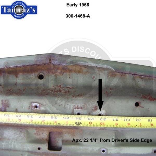

See this ... this is my VFN hood. See those holes for the hood latches ... they're all 3/4" of an inch off. You can't move them (without a LOT of trouble) because the nuts are 'glassed in from the back. When I contacted VFN their response was "you can adjust the grill support". NOT ON A MOPAR YOU CAN'T !!
And they botched the front corners on both sides - the profile doesn't match the fenders.
AND ... for a "hinged" hood - not a whole lot of underside support structure !!
Maybe Glasstek are better !!

On that VFN hood, The 68 Roadrunner and GTX had two hoods, early and late with those holes
in different places and two different grill supports! After that they were all the same.
Well **** !! I'll have to measure mine. Sure wish I'd known this a few months back.
Its too late to change grill supports and we already drilled holes for hood pins (which I really didn't want to do), and I've drill out the glassed in nuts hoping I can put new ones in the correct spots. ****, ****, **** !!
