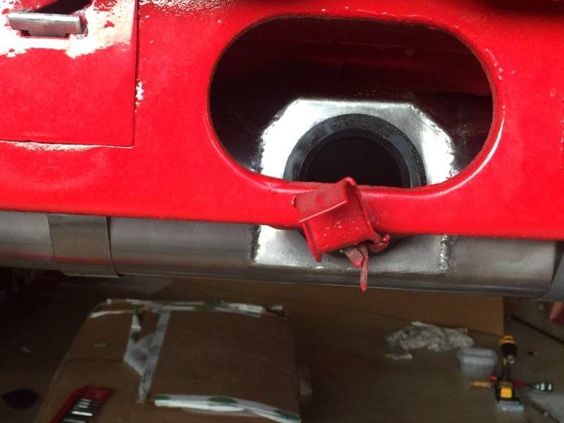

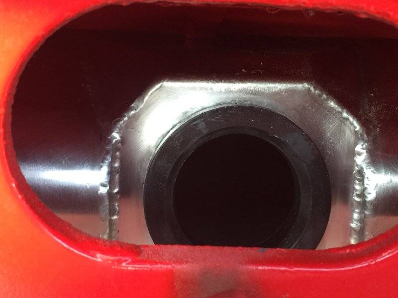

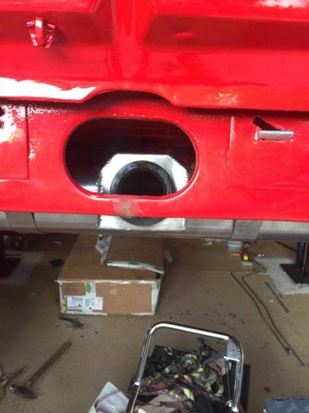

Have a 1969 road runner I have a custom-made stainless steel tank by Ricks Tanks how much trouble do you think I’m gonna be in with this filler tube not lining up. If I cut part of the body how much of the bumper do you think I have to cut if any?’s and he helps her comments would be great
Looks like a different tank would be best. Second best thing might be to shim the front of the tank down some to angle the inlet up some? Hate to see a hackjob done to the body and bumper.
Isn't there supposed to be a hump that fits in floor pan? OOPS!
The floor was replaced before I got the car.is there suppose to be a bump in the floor.
Just look at at 68 for sale on this site it does have bumb. I will have to check my trunk floor.
Thanks for all the help. The gas tank was 1/4” bowed the floor was bowed down 1/4”. had to cut the floor. Fits now
