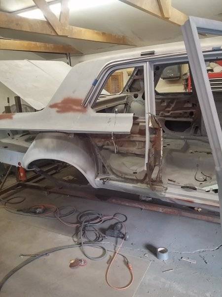

Question for you body guys or tech ones. I have a 65 Plymouth that I’m converting to a 2 door from a 4 door. I have quarters off of a doner car and sitting here thinking of how much I want to cut off each. Use the whole 1/4 or patch in what It will take. I have the skills and platform to do either. I’m thinking about welding the joints and how hard that is sometimes to get level and straight. I made a line where if I cut and splice (least amount) opinions would be appreciated if you’ve done this. Thanks in advance

I have 2 sedans for the posts that I’ll cut out. The guy I got the 1/4s from cut the top part to make his hardtop into a sedan (63) reason I got the 1/4s cheap (free). Also have doors-windows-track, cranks. My 2 64 stuff is rusted bad or I’da used them, would’ve had to piece and patch a lot. All the 4 door parts will be removed drilling the spot welds.

it's easy to do the conversion. The pinch welds, bends,screw holes will match up . It's just a mater of first hanging the 2dr sedan door first to have the door gaps / seals fit right. You need to be able to latch the door to the quarter jam with the 1/4 window post in the roof line ...all kind of loose test fit.
with how the sedan quarters look ,It looks like your missing the quarter window post area.
Yes, the guy I got them from cut the post part out to make his 63 hardtop into a post car. I can either cut the complete post part out of one of two post cars I have (has rust holes) or take the top of post and piece it back in. Still debating on that.
Keep in mind the steel channel that holds the top 1/4 window to the roof line , sets the window door post location.
Yes I’ll use that as a guide. Might have to use the 64 post part since the 63 has a different stricker attachment for latch. The 64 piece has a couple rust outs so it’ll have to be patched, no biggy. I’ll make patterns of door opening before any cutting (jam to jam) with a lot of test fitting. Yours looks good so far. Not sure I want to do that much panel welding, the least the better for me.
