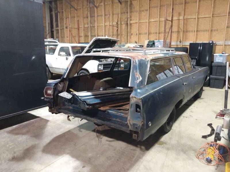

Finally got her home this past weekend.

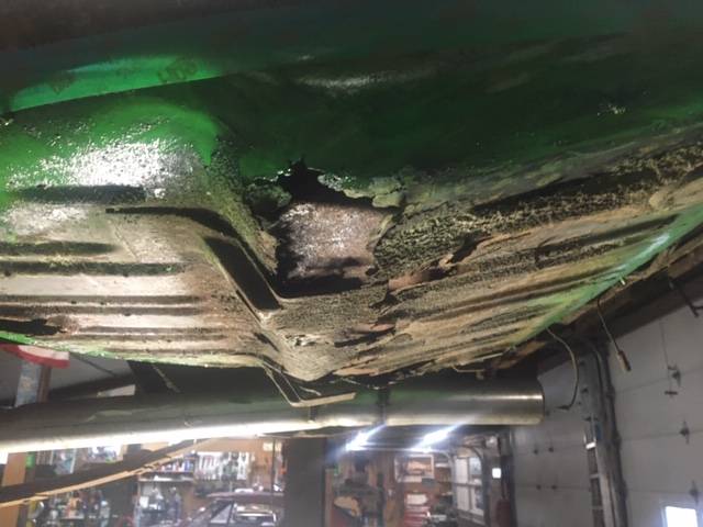

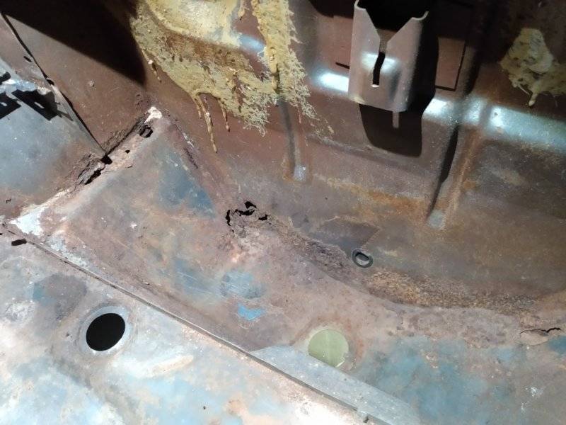

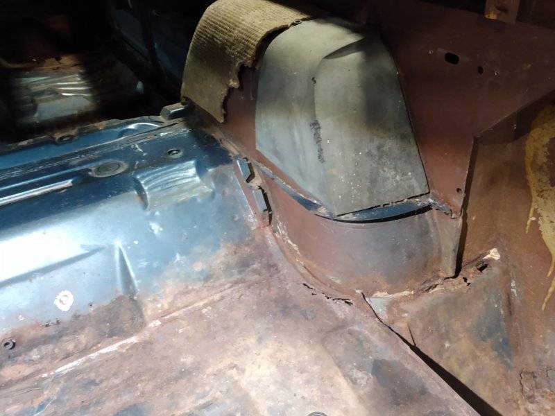

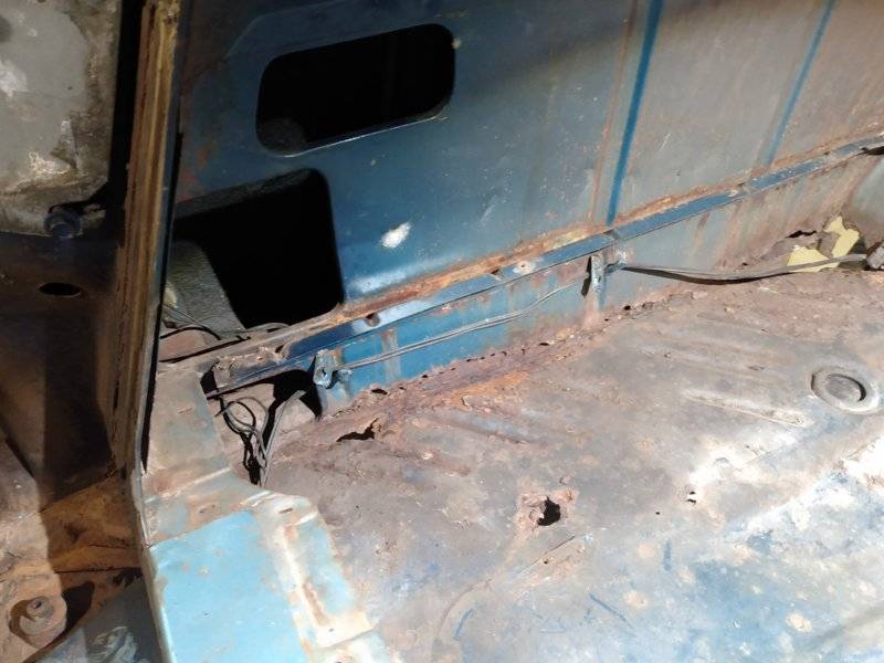

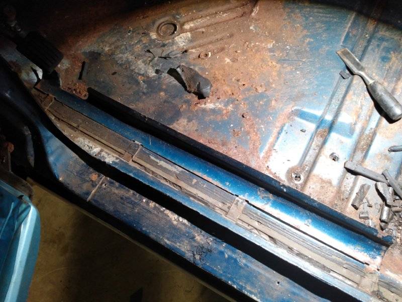

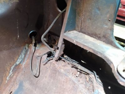

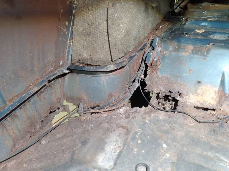

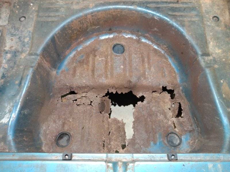

Well I got all of the rear interior panels out and it doesn't look good. It is going to be a test of my metal working skills. I guess now I won't have a issue on making my mind up on mini tubbing her. If anyone has a line on a wrecked or good rear section from the front of the rear wheels back please let me know.

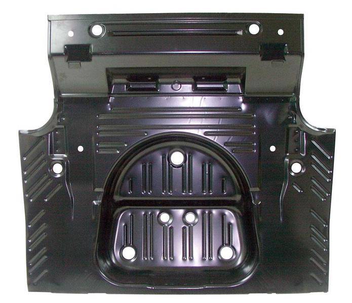

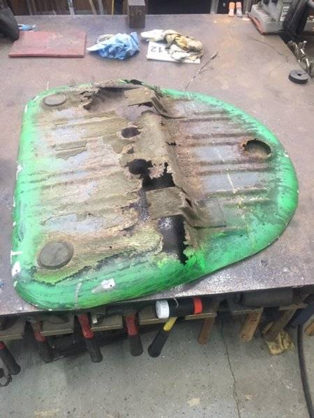

Take a look at a 66/67 Belvedere Trunk pan. They look very close to the one pictured above.

Multimopes, I have thought about it bad. The only reason I don't want to do full tubs is I want to use the rear seat still.

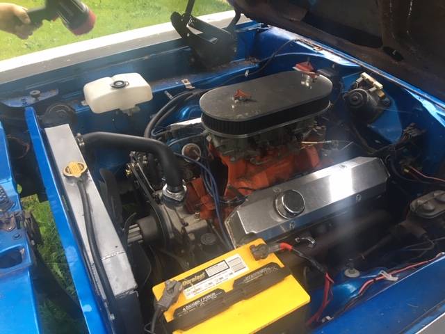

Lol oh yes. I have a stroked 440 back home in Cali at my Dad's shop just waiting for a set of Indy or B1 heads to drop on that engine bay.

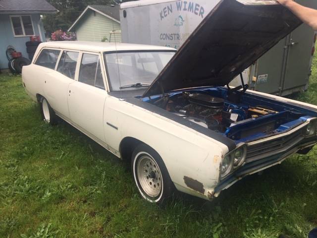

I am working on one of those right now, a buddy's 69 wagon. Same 3rd row footwell issues as yours, we ordered a new 66-67 B body trunk which I will be putting in. Car has a 440 6pack and 4 speed, very cool.
