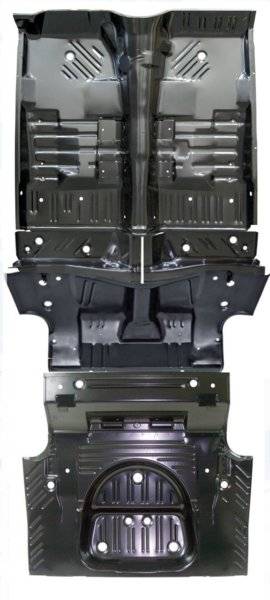

I would say 66-70 B-Body should be the same. I don't have an official answer but I would look into that panel Seems like not much changed through the years. I also don't know if the 2 door and 4 door cars got the same floor pans. I have a hunch they did but I haven't seen a 4 door car gutted.

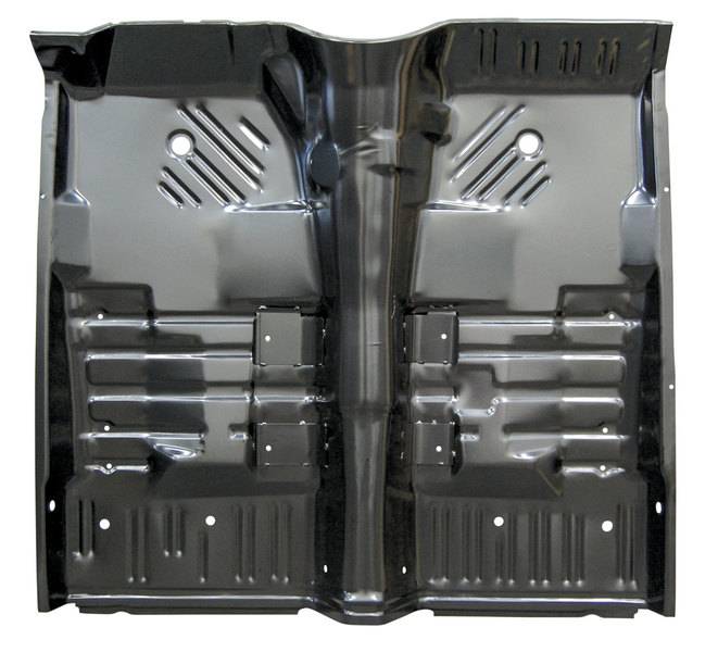

There are literally 4 pieces to the floor. The large pan, 2 pans for the foot area and one larger pan for under the rear seat area to the trunk pan. You will have to look at these pans to see if they are the same for your car. All of these pans are located here on AMD site. Looks like the trunk pan was used from the 66/67 because of the spare tire well.
This is the larger front area.

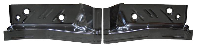

Here are the rear foot area pieces.

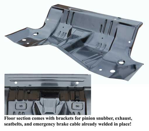

And the final part that meets the trunk pan.

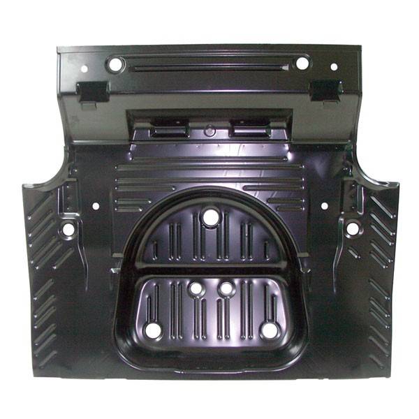

And the trunk pan. Up to the rear seat part that meets over the axle.
