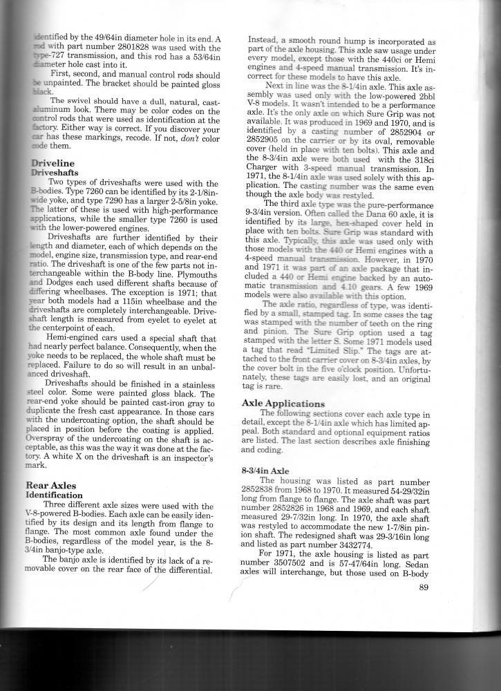

"Green" was right, there are a number of rear ends. Got me thinking, so I looked it up in a resto manual. I attached a copy of it.

Maybe I am blind, but I do not see any pic of the rear end???
No because it is a 8 1/4" axle and "oldbee" thinks it's absolutely without a shadow of a doubt a Dana 60 for some reason I guess he failed to realize the 8 1/4" ever exisited under a 69 B body! which it did it was the original axle that came in the car as the car. And I am pretty sure of what all the axles look like because I had a Dana 60, 8 3/4, 7 1/4, and 8 1/4 all before! :rolling:
