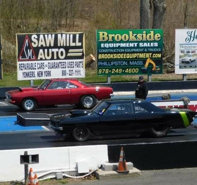

Saturday was our first race this season.
I made one time shot and parked it.
A lot of bugs to work out after having the car completely disassembled for a year and a half.
Nothing major, but needs some attention.
It went 9.77@ 137 off the trailer.
I was happy with that, but definitely will be better.
I never cleaned the carb after sitting on a shelf in the garage for 17 months in my haste to get it together.
Did that yesterday and found 2 high speed air bleeds completely clogged.
Taking it to chassis dyno down the street today to fine tune.
Another race this Saturday.
We'll see what happens...
Check out that beautiful 8 second Dart I'm lined up with.
Its for sale too.
