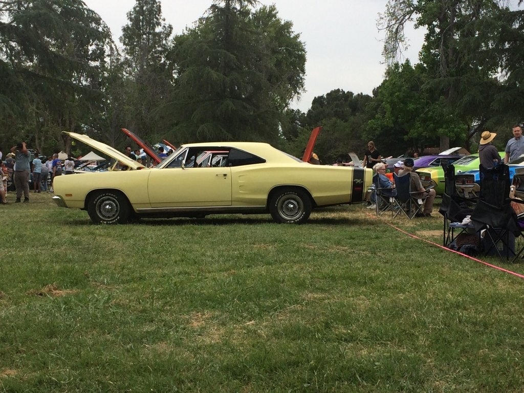

Yep, lets see the rake now. My gut says no. Lots of personal preference here. Don't over do it. I can bump a parking stop sometimes but its just the cradle.
I grew up in the "air shocks and L60 tire" era, back in the 70's, so I tend to shy away from the tails up approach.
I like a little rake but not much more.

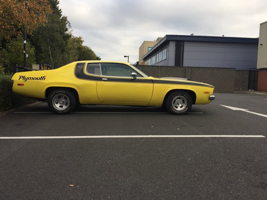

Gonna try get it out today and see how she looks from the side. I'll get some images up later

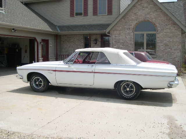

I have my 63 Fury elevated about 2 inches rear and then dropped the front about an inch from where it was. I had the castor changed to + as much as it would allow (had issues with steering recovery and this helped that). In my case two things I have to be wary of bottoming out and not getting too close to curbs. The pic here is before I did the work including dropping the 14 inch wheels going to 15-inch chrome magnums larger tires. I'll send another pic of what it looks like now (I have to take one) it sure looks meaner BUT I think I need to back off on the adjustment to level it a bit more as you know there is a "range" where it gets to be too much one way or the other for street driving...

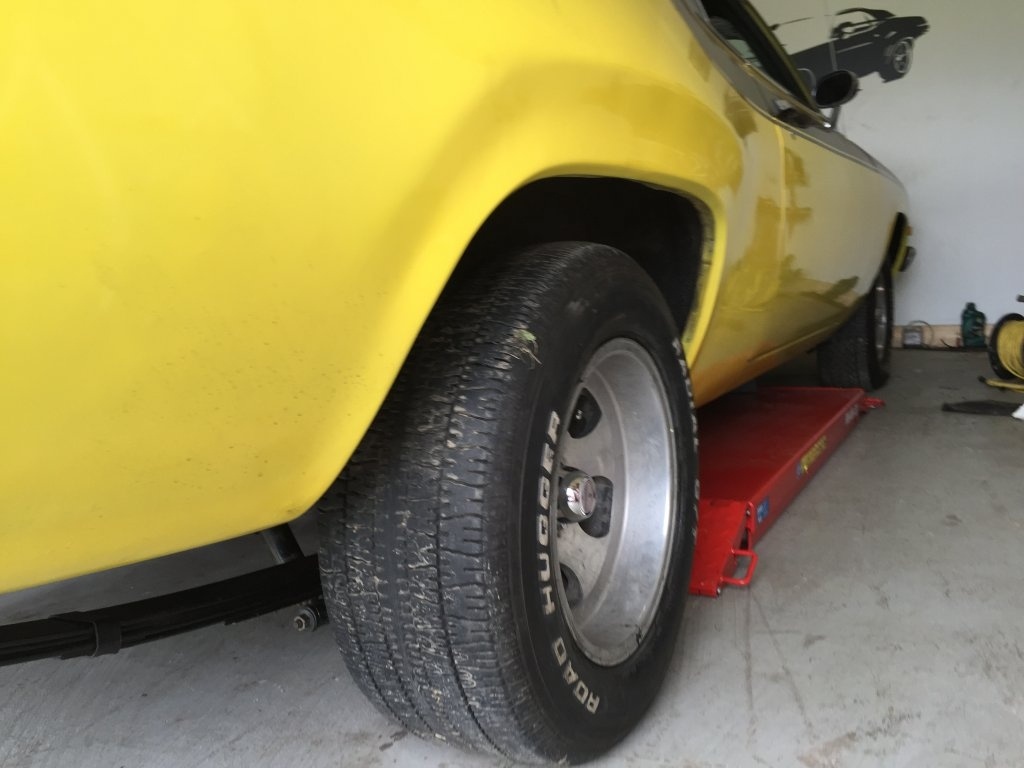

Finally, got the car out. I had I do a little job on the exhaust and wait for a break in college.
Haven't messed with the front I think I'm happy with how she sits.
