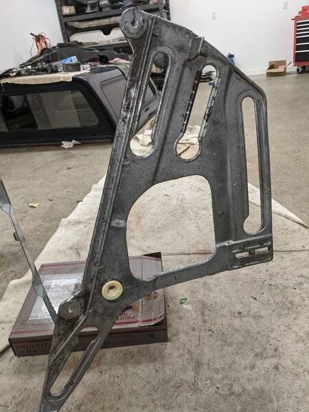

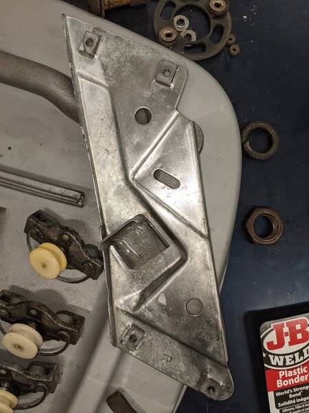

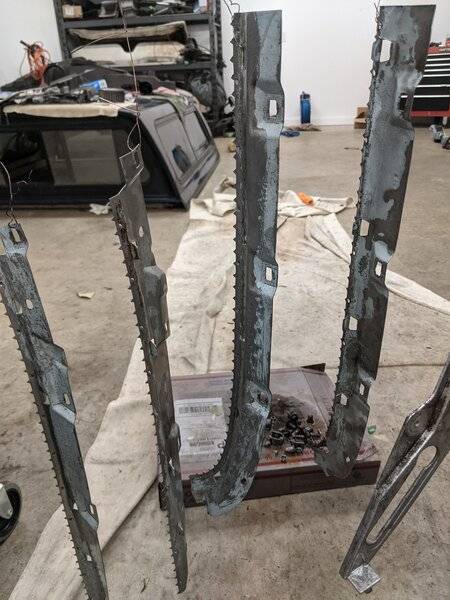

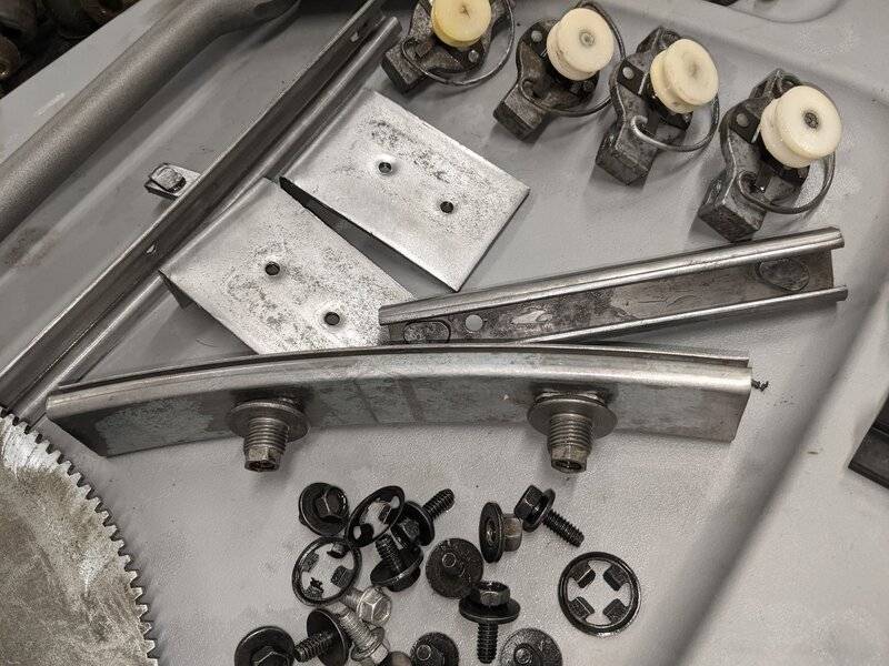

What parts do you think need clear zinc in those pictures? Headliner tack strips remind me that they used a galvanized steel. No way to replicate that.
The big window frame is aluminum or pot type metal. The hardware and tracks are all natural, at least on my 67 they were. I have a local plater that does small batch clear zinc and he can simulate yellow dichromate. I do all my own parkerizing, zinc phosphate at home. Most fasteners are phosphate, electric fasteners are typically clear zinc. Everything you have there would just get EvapoRust’d and protected.

To me it seemed these pieces had a light charging and after looking at moparnation thread, I assumed that coating was zinc.
I'm thinking I'll just keep doing what I'm doing for now.
Doesn't seem like these pieces need to be anything better, they're inside the door and with the Boeshield they shouldn't rust.

As for the OP's question....are you sure those headliner teeth aren't Galvanized? The other parts do what ever you think is best. At 58 years old I surely hope I'm never inside my doors again with the years I have left, after that it's #1 Son's problem!
No rust "preventor" is permanent. Boeshield T9 or ECS's RPM for that matter. That said, I have put over 2500 mile on my Bee this Summer, as well as a fair amount of road miles last Fall and nothing RPM'd is showing any signs of rust YET. If my 4 post hoist ever arrives I'll be putting it in the air and lightly spraying everything that's bare with T9, as once assembled it would be pretty impossible to heat and recoat with RPM.
Maybe I should ask:
- what is the original finish on these pieces (headliner teeth, window components). they all appear to have a similar light coating maybe it is a galvanized coating I don't know?
- should I paint them or leave them raw with Boeshield (I did not remove the coatings just whatever came off from the evaporust and my scrub pad. So they are not entirely wrong per say).

these coatings might leach thru and stain the head liner
Good thought!
I'll remove the coatings and paint them with a zinc. But I'll do it later and before installing them

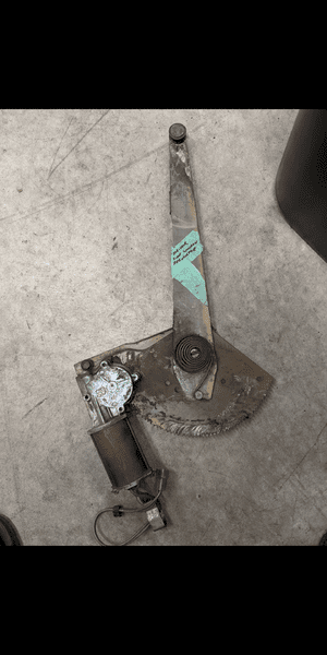

It looks to me like the window regulators themselves all seem to have maybe cosmoline on them.
