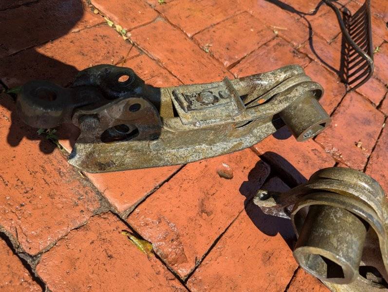

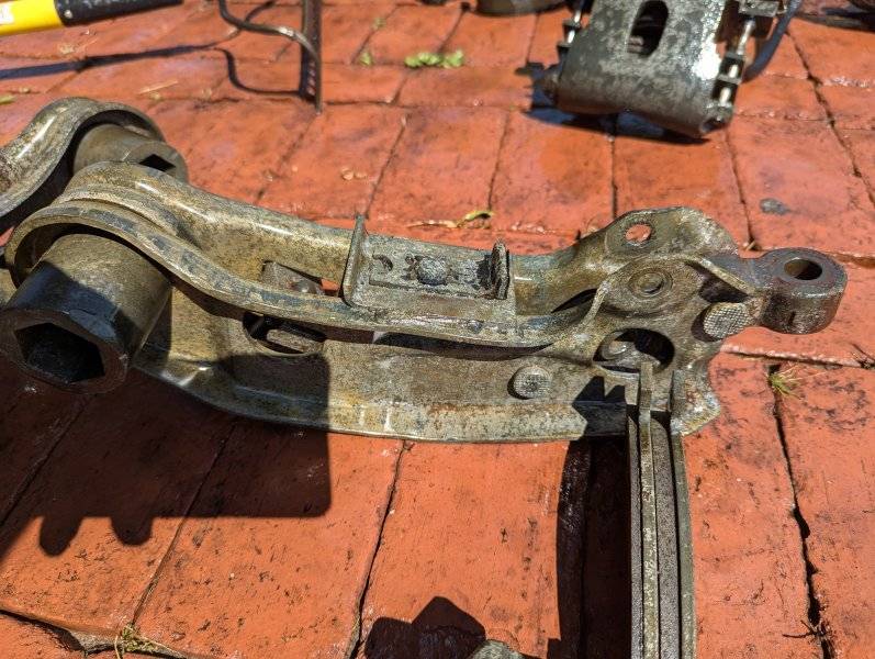

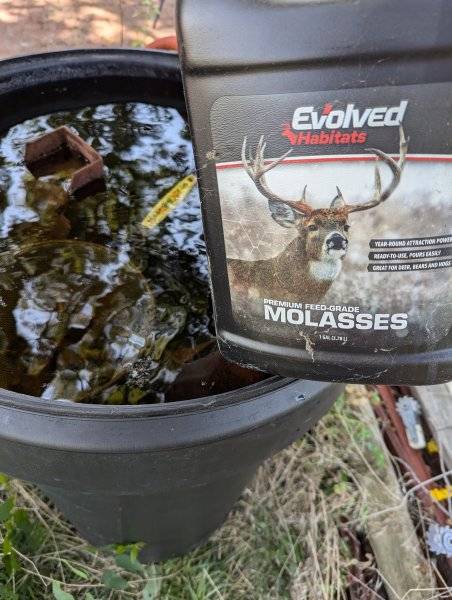

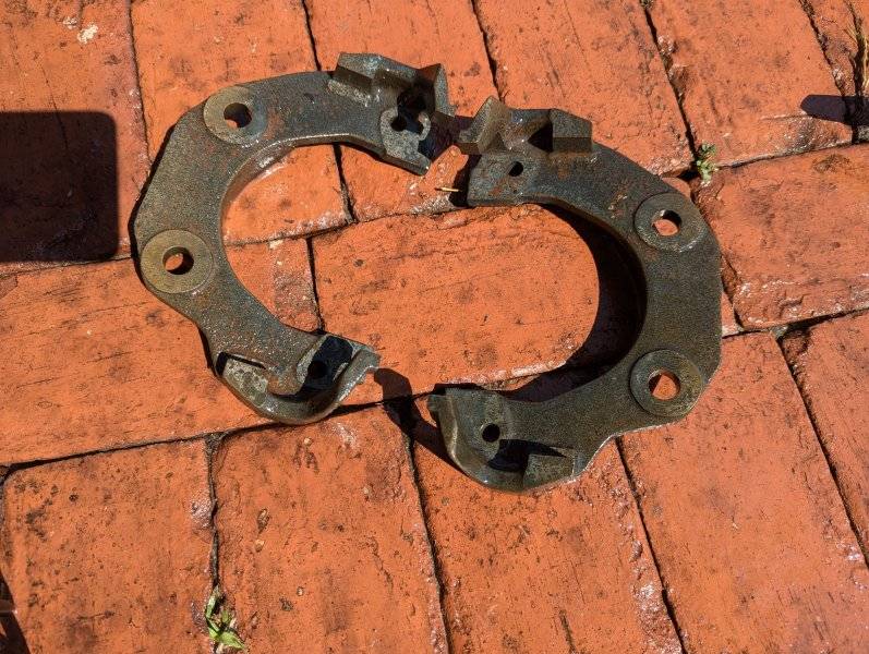

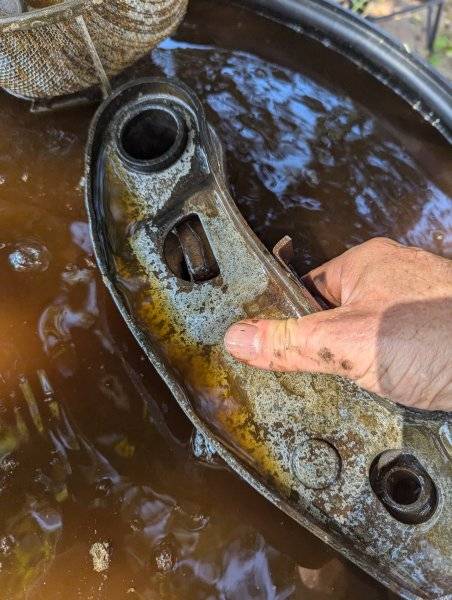

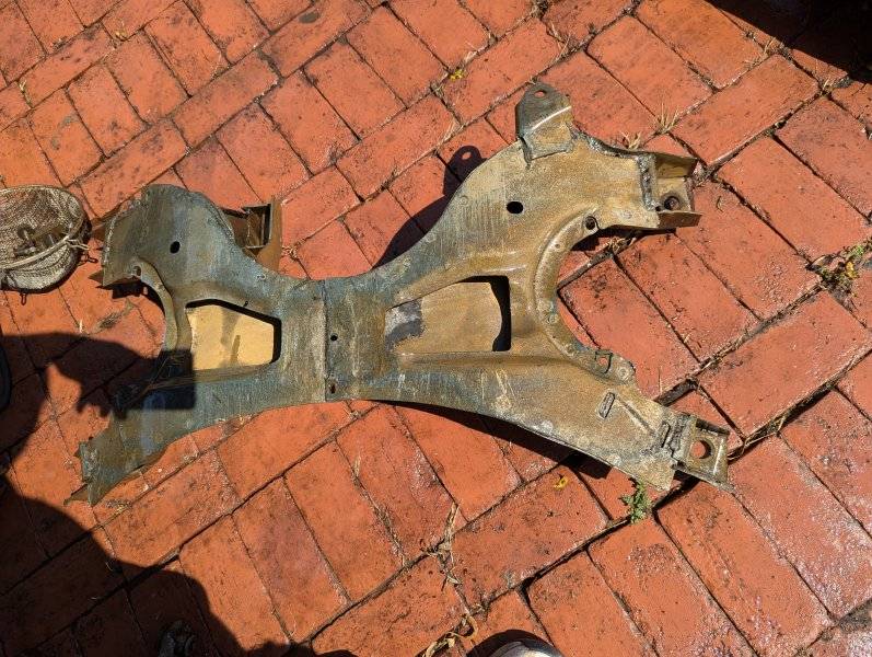

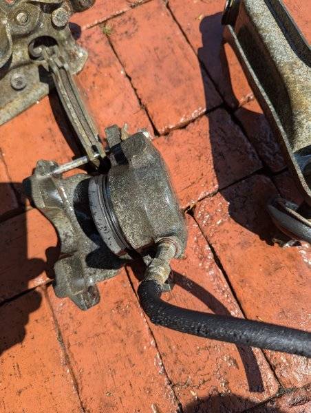

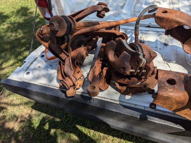

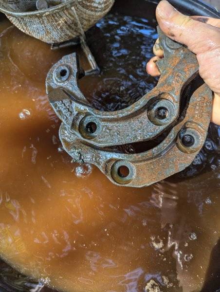

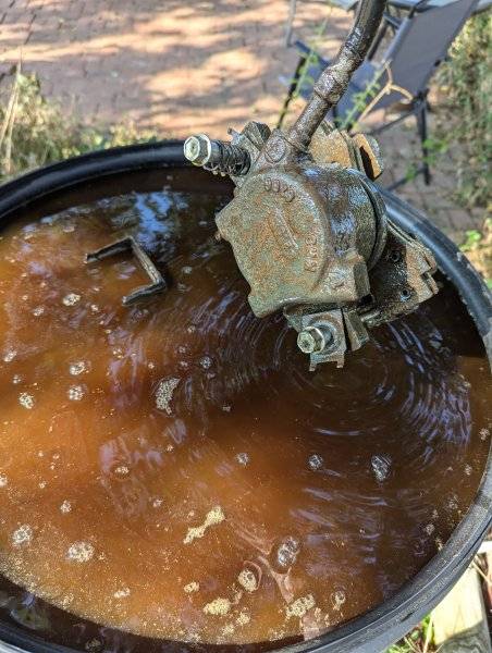

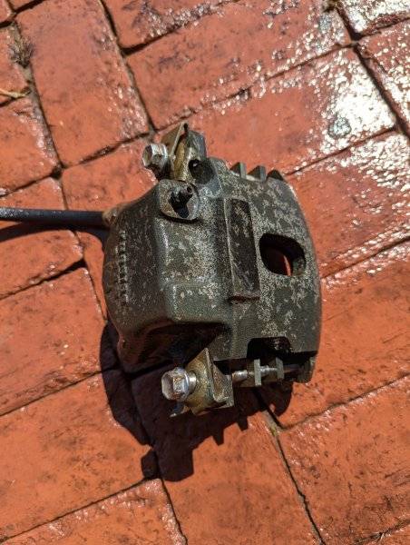

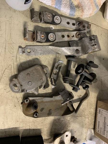

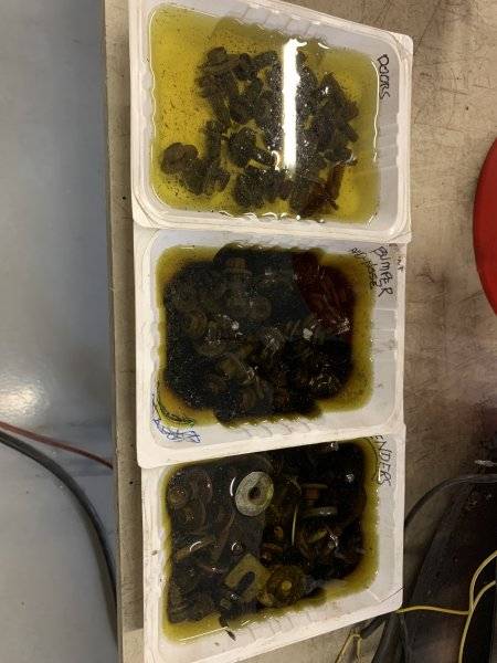

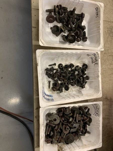

Rust removal, better than evaporust and 10x cheaper..
Thanks! Thats what I was thinking, something food grade so I can pressure wash it off without creating a hazardous waste site.

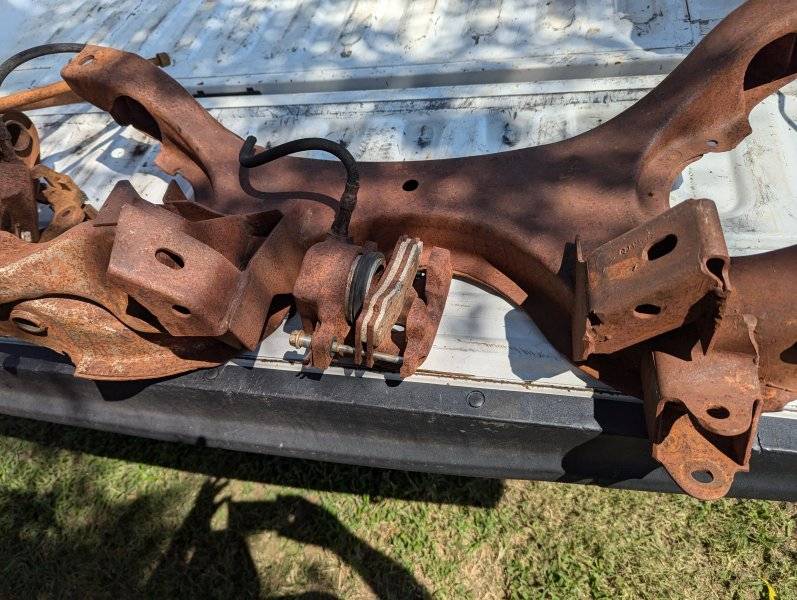

I tried the gel thickening trick, did not have good results. Brushed heavily on a rusty floor pan, covered with plastic, and after 2 days the heavily rusted areas are still there. It did remove minor surface rust tho.

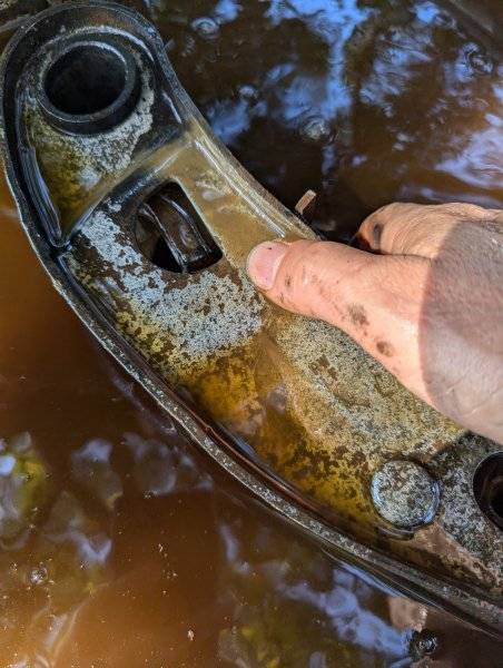

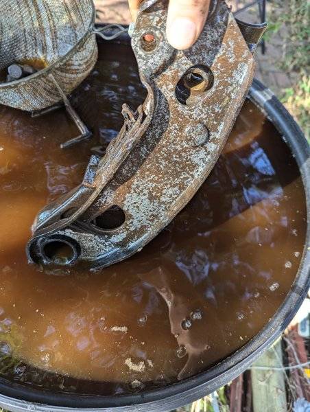

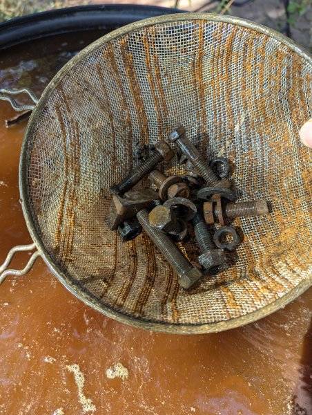

I believe it needs to be completely submerged in the un-thickened solution for it to work. I have been throwing heavily rusted small parts in a bucket of it and it works great that way.

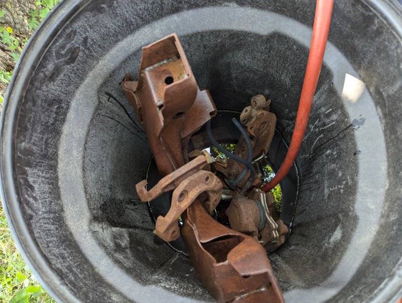

Was worth a shot..... i made a big tub of it just to throw stuff in
