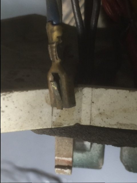

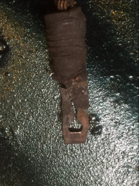

Does anyone know where you get a new connectors for the firewall side of fuse box?
Those are standard Packard 56 and/or 59 series terminals. They're available at any local auto parts store (Napa, etc.). Just take the old connectors in and they'll know what to get for you.
agreed... don't spend those ridiculous prices requested on "resto shops". They get lots of them and make the "correct kits" for you overpriced.
If nothing around your area at local shops, make a search on any electrical supplier on the web and will find them really nice prices by packages and several gauges
packard 56 is the name
Thanks, I knew someone had dealt with this before.
