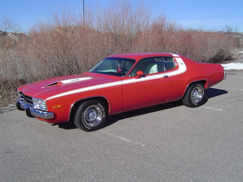

I am using 1.06's on my 73 Roadrunner with Bilsteins. The ride height adjusting screwsare not in very far, but the ride height is perfect! Here is what it looks like
