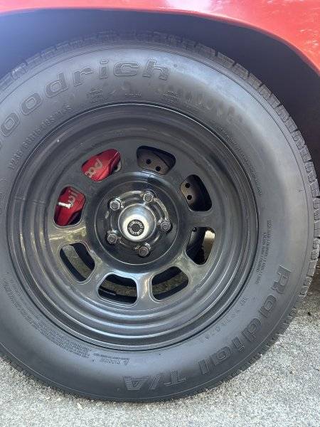

Hey Everyone - I’m posting my most recent project on my 70’ Charger that included a full front suspension rip and replace, plus the addition of a 6 Piston Wilwood Disc Brake kit. Please note that my charger has the front spindles from a 1973 Challenger (larger diameter), which allows for the 6 Piston kit from Wilwood.
I decided to go mostly with items from Firm Feel to keep the existing suspension design after talking to some forum members (thank you @Kern Dog for the commentary). I must say, I am impressed with the parts from Firm Feel and I really like how all of the bushings are readily available for future replacement. Everything fit perfectly and was exceptional quality.
Parts list:
  • Firm Feel Tubular Upper A-Arms
  • Firm Feel 1-1/4 Front Sway Bar
  • Firm Feel 3/4 Rear Sway Bar (not yet installed)
  • Firm Feel HD Adjustable Strut Rods
  • Firm Feel HD Adjustable Tie Rods
  • Bilstein RCD Shocks (supplied by Firm Feel)
  • Firm Feel Bump Stops
  • Wilwood 6 Piston Brake kit includes hub, Calipers, 2-piece rotors, steel braided brake lines,etc.
  • Refurbished and reinforced LCA
  • Mevotech Greasable Lower Ball Joints
  • Hotchkis 1.1 Torsion Bars
  • Magnumforce Subframe Connectors
Other:
  • Ride height (floor to fender lip) at 25 inches and yes, I know the fenders can be off so I confirmed equal leveling to the frame,
  • I did the alignment myself and achieved +5.5 caster and set camber to -.5 degrees. Car drives straight as an arrow, wheel comes back to center, and everything looks on point.
After all was said and done, wow! I can genuinely say that I am surprised at how well the car handles. Even without the rear sway bar installed yet, the car feels incredibly planted and no noticeable body role during high speed on and off ramps/ higher speed turns. I took the car up to 110mph and it was very stable/ confidence inspiring. The subframe connectors also had a very noticeable impact as well; I went with Magnumforce because they bolt to the floor pan. The car no longer creaks when going over a speed bump off-center or when going in and out of slanted driveways. When I lift the car up, the door gaps also no longer change, indicating no noticeable body flex.
If anyone has any questions, let me know.

The wheel brand is Bassett, D-hole style and the sizes are:
Front -> 15x7 with 3.75” back spacing
Rear - > 15x10 with 5” back spacing
Tires are BF Goodrich, sizes are:
Front -> 235/60-15
Rear -> 295/50-15
