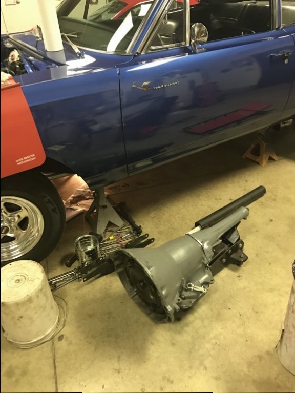

It left the house without a trailer... :(

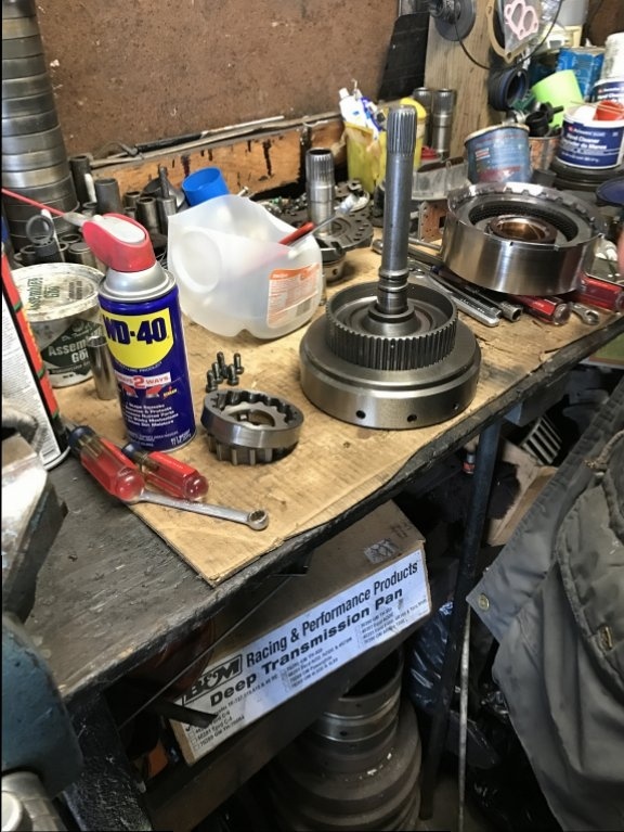

Took a buddy for a ride, pulled 2nd and it hit good then loud bang and the motor just free rev'd. No gears forward or reverse. Something in the trans broke. Lucky for me I was able to coast into another friends driveway. Only thing I'm pissed about is I just put the tail pipes on, tack welded them this morning so they would stay clocked good. Now I gotta take them damn things back off to pull the trans.

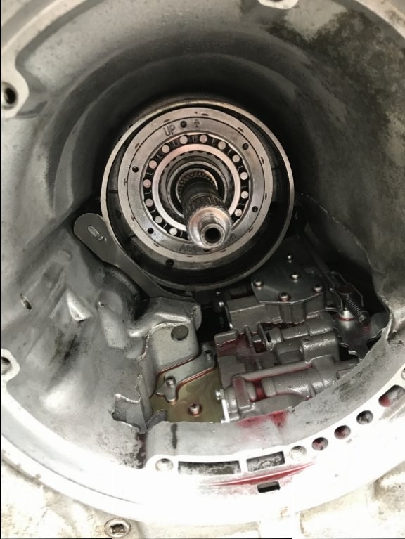

Has that converter/pump combo been together before? Some pumps need a bit of grinding on the front of the casting to clear the converter case. Did it break the inner pump gear?

Yes, used that converter in that particular trans as well as the one in the dart with no issues previously. I had the convertor rebuilt though and had not pulled it since.

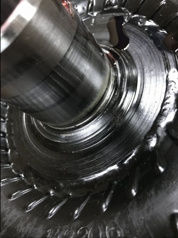

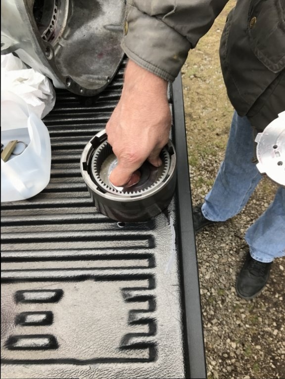

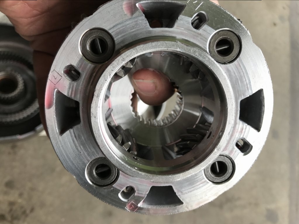

The converter is definitely "broke" and the culprit. Also appears to be running out of center and contacting the pump for some odd reason. Took the trans over to my dads and we pulled it down. Other than the reaction shaft it's mint. So now I need to send the converter off somewhere, won't be the same place as last time. Also gotta check the end play on my engine, hope that didn't screw the thrust up. Gonna do some measuring on the crank flange. Something isn't right whether it was the convertor, crankshaft flange, or maybe block dowls..

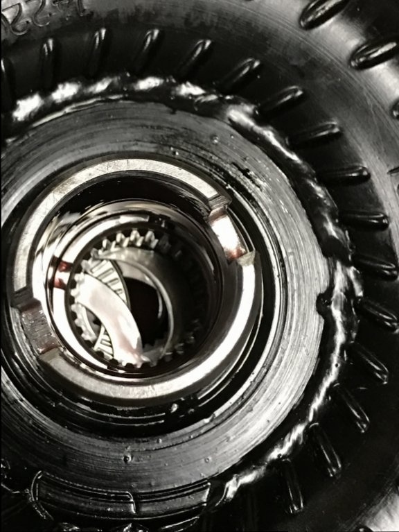

Sent converter out, apparently it broke the turbine. I did notice parts floating around when i boxed it up. It was not hitting the pump.. Unfortunately the company I sent it too cannot do anything with it. I have a relatively fresh J converter so I'm gonna give that a shot. I did check on a few new ones, ATI recommended a tight 8", Ptc 9 1/2, & coan said 9". Guess I'll see how the j acts before I do anything. My other option is to go back to a clutch, I have a hemi box sitting here that needs some parts. I could make it happen though for probably slightly more than a new converter, depending who I choose.
