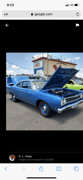

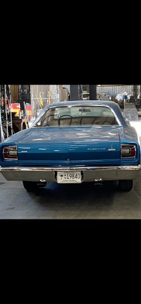

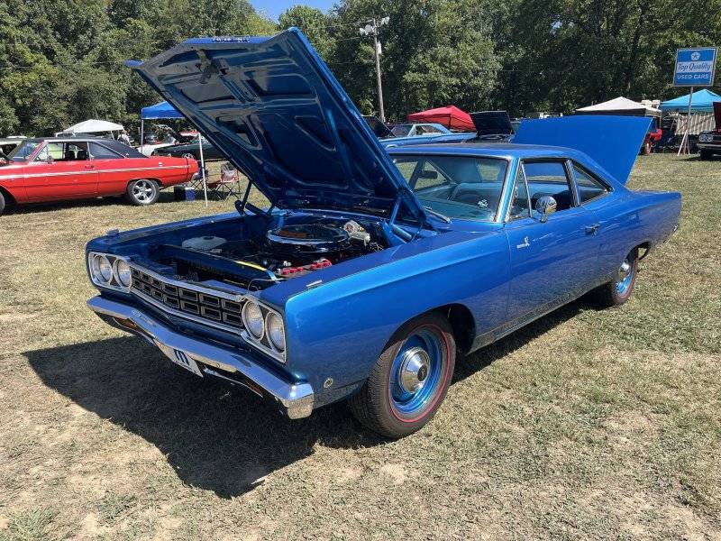

Glad you got it worked out. I have a friend there that is putting his blue 68 Hemi roadrunner in the show. If you have a minute stop in and check it out. Awesome car.
