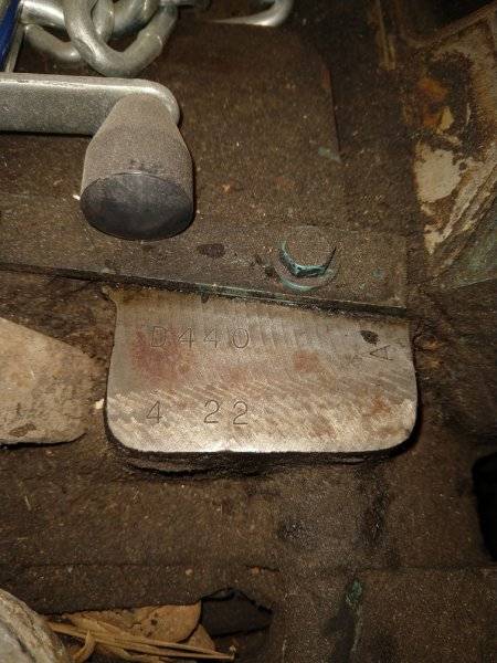

I've come here for some help and guidance. I have a '66 Satellite that I have been slowly working on for about the last 10 years, I bought it as a rolling shell and the seller included a '68 440 and a '71 727. The engine looks like it was marked from a junk yard as it has "1968 New Yorker" written on the valve cover in paint pen, and the engine is heavily caked in old oil/grease/road grime. I would like to start working on rebuilding the engine, this will be my first engine, so I'm looking for some advice. I've picked up a couple books to help (Don Taylor's 'How To Rebuild Big-Block Mopar Engines' and Chuck Senatore's Big-Block Mopar Performance') as I've read several posts suggesting these books. The car is going to be a driver so I'm not looking to build anything crazy, as this is my first engine I really don't know what to expect cost wise, but if I can keep it under 5K I'll be happy. Current plan is to keep the internals mostly stock, install a slightly bigger cam, carb, headers, and replace the points with electronic ignition. I would love to hear some suggestions, advice, or whatever you've got that might help.
A few of questions to start with;
1) on the pad with the block stampings, what does the sideways "A" off to the right indicate? (it's hard to see in the picture but it looks like its been stamped 3 times on top of each other.)
2) after cleaning and disassembly should I leave the crank in the short block when it goes to the machine shop or bring it along with the block? does it matter?
3) what are some methods you use to mark and keep organized the parts like lifters, rod and main caps, etc that you don't want to mix up?
