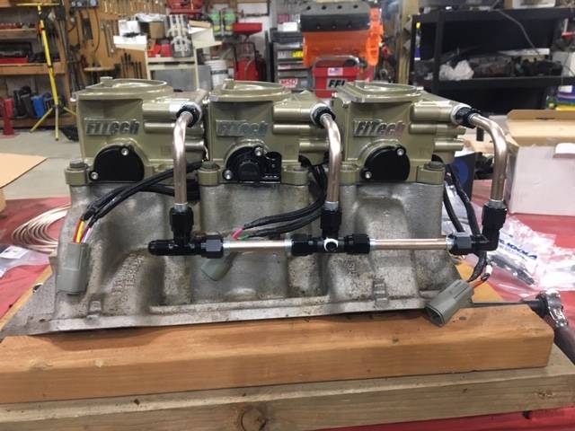

Would anyone be willing to share some pictures of how you plumbed their fuel lines to the injectors? Did you follow the same path as the factory or did you route them up over the bellhousing? Thanks a bunch

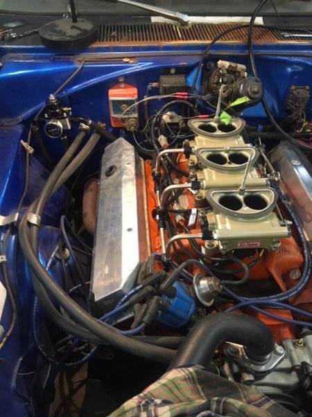

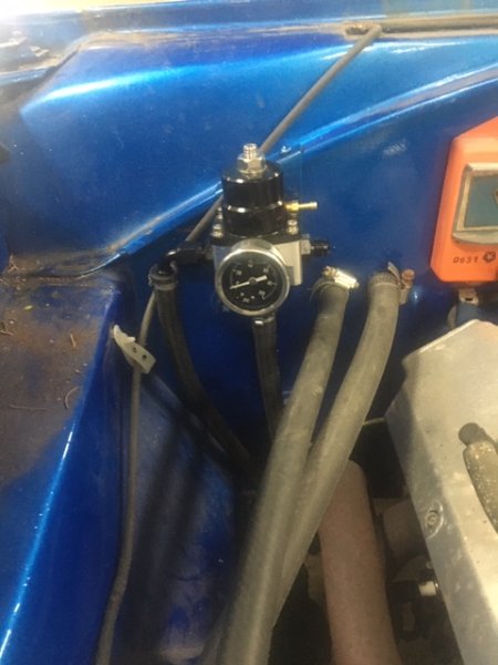

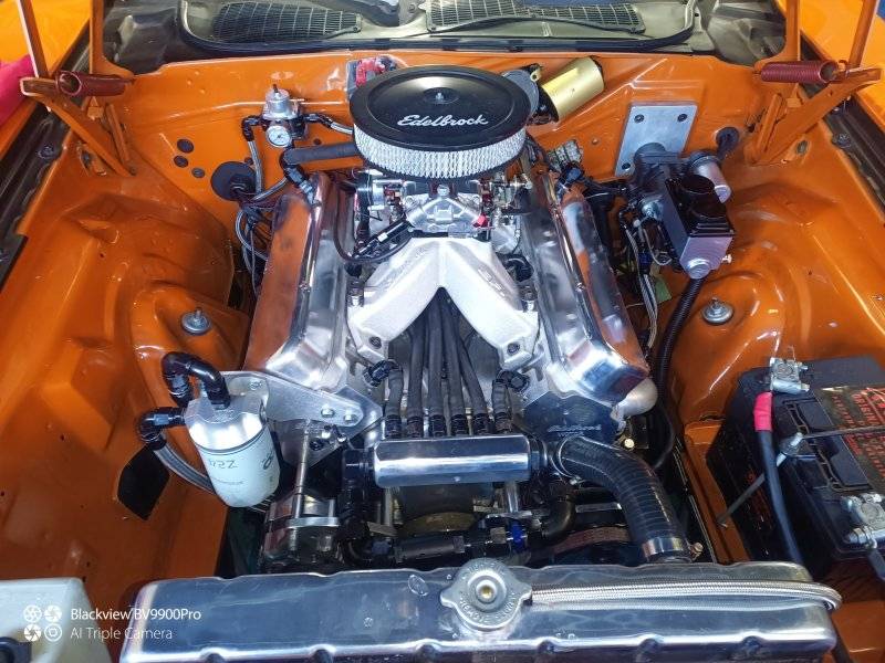

This is how i originally done mine regulator on firewall filter bolted to R/H frame rail

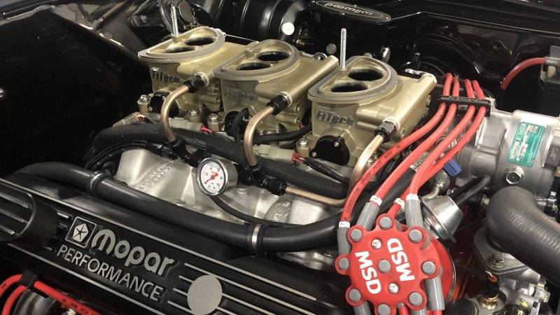

Cant send pictures as now i have port injection all different other pic gives an idea where to put the line & regulator or you could use an intank system

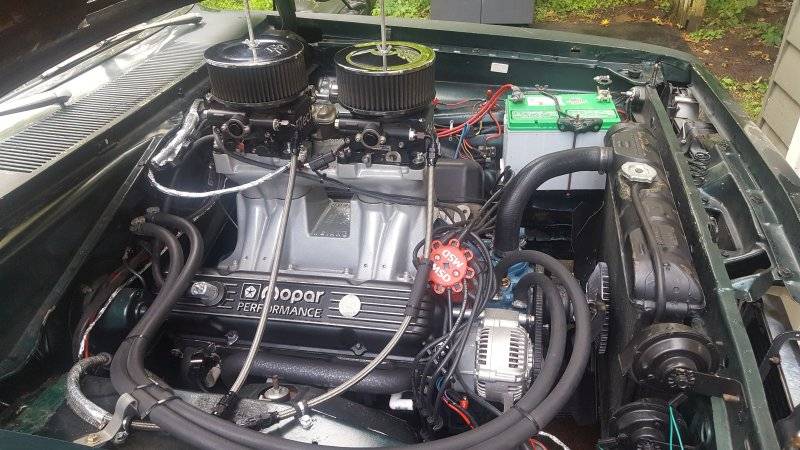

Are you looking for ease, sorta original, etc... I ran my 4bbl Fitech the same route as a factory fuel pump. My return out the back by bell housing and along feed line back to tank. I used 3/8 factory style steel line for feed w AN fittings at the ends for connection to tank and Throttle body.

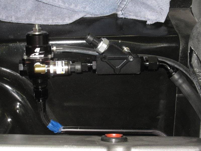

Followed the same route as the factory with braided PTFE, up on top of inner fender, no return, 'Corvette' filter/regulator on rear frame near tank.

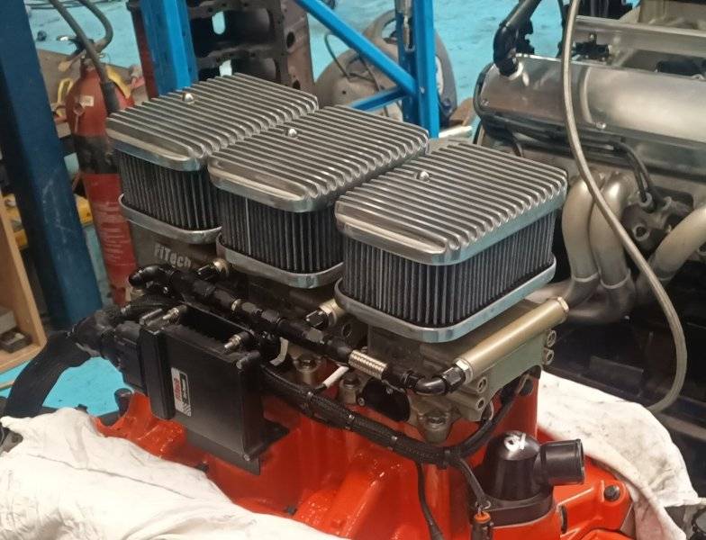

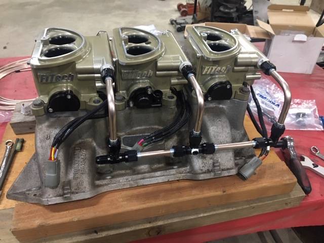

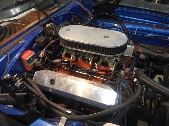

This is a 69 Ply wagon I did for a guy. I used Nicopp 3/8 line, AN6 fittings. The first pic is one I got off the internet (maybe even here) as a reference.

Thanks I used some Acft aluminum tubing and the fittings are from Amazon
Having built an Experimental aircraft, unless there is a call out, there isn't anything special about aircraft aluminum. For tubing, I used both 3003 and 5052. The 3003 is soft compared to the 5052. What is specific about using AN fittings, is using the the correct flaring tool, not automotive.
I used the Fragola fittings, easy peasy, no tool required.
