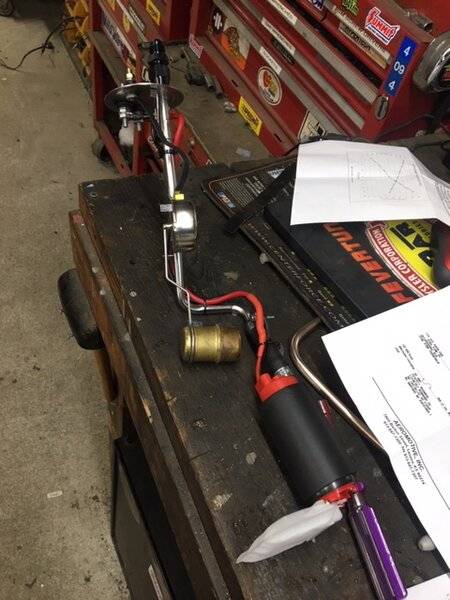

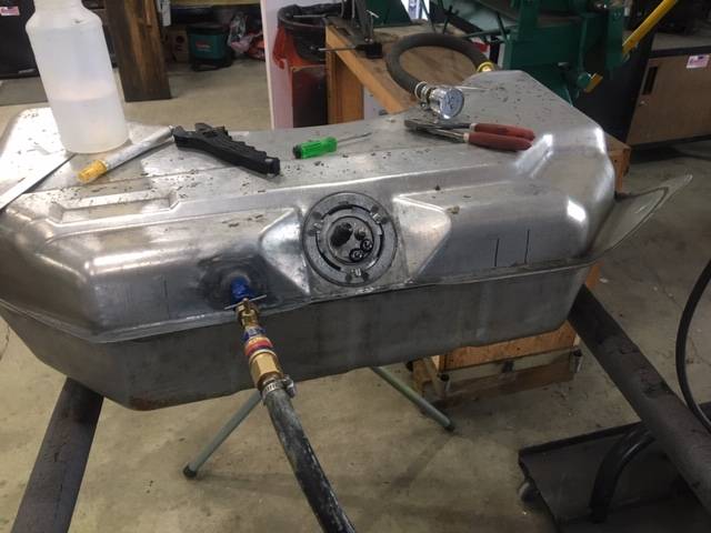

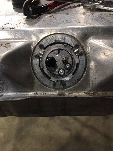

On this car I decided to use an internal and to that end, I decided to make a "retro" fit system in which I attach a pump to the end of the pick up. Holley sells a kit just like this for something like $300 and it is pretty decent kit. I chose to make my own and it cost probably $200. I used a new stainless steel 3/8" pickup and an Aeromotive Stealth pump that will produce 90 PSI.
The challenge was bringing the wires out of the pickup and getting it sealed.

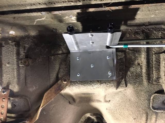

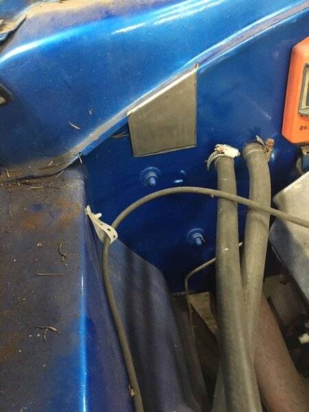

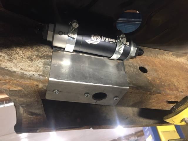

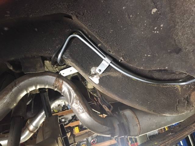

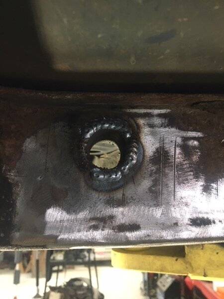

As a part of putting in new lines, I needed to open up the cross member to allow two lines to pass through with AN nuts.

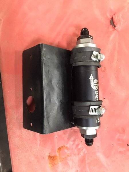

I should note that in this build I opted to run steel lines front to rear, they are connected to the tank via -6 AN nylon braided line, I use Fragola series 8000 push lock line and fittings on my builds. The steel lines end near the T bar cross member where they transition to soft lines, the feed running to a 40 micron filter and the return right up to the bypass regulator.
Note, in the pic of the hole, I actually had to cut it out and redo it making it larger, I believe it ended up being about 1 1/4" ID.
The reason that there are 2 different colors is because the first green (PVC coated) line I made kinked, buy in the end it worked out because the green is the feed and the silver is the return.

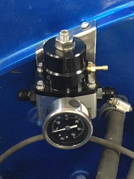

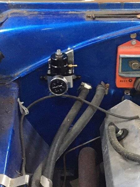

As mentioned, in most cases you will need a return line. Some systems allow you to feed into one side and return out the other (usually into a regulator). In this case I am using a bypass regulator, so the feed line and the return line go to the regulator.

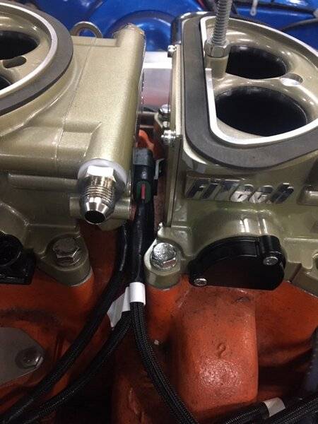

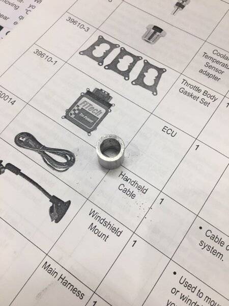

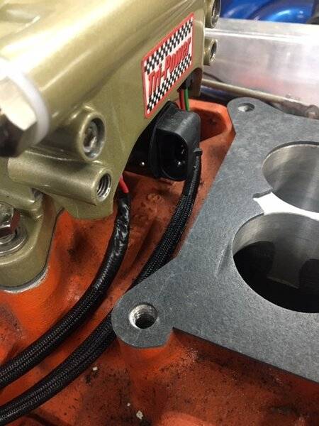

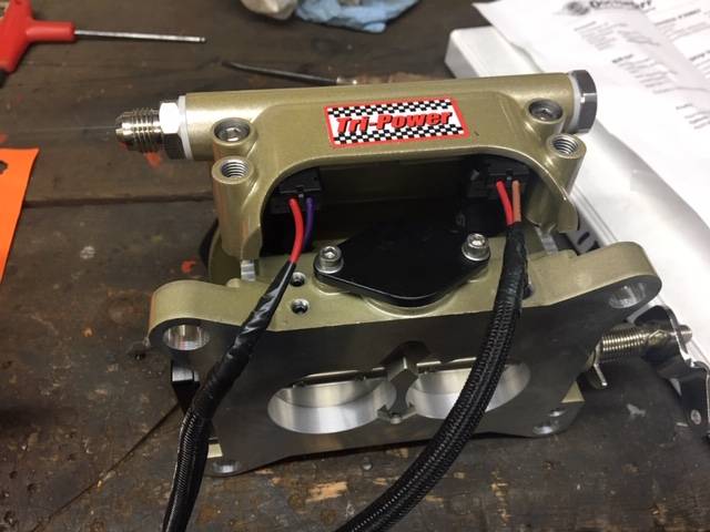

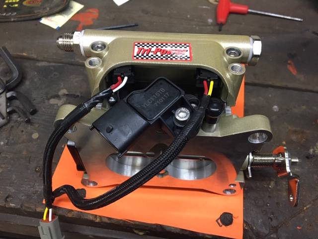

People interested in this system should understand that Fitech attempted to make a system that would be at home on pretty much anything, especially any engine/model that would have or could have had a 6 pack, 6 barrel, tripower, etc. In designing it, they had to take a lot into consideration so there are some things that as a Mopar guy you find strange, such as the holes that the bolts go through to hold the TBs to the intake are 3/8" and very sloppy on a Mopar intake. However, Fitech includes a number of small aluminum tubes (6 of them) in the kit which you put into 2 opposing holes in each TB and then the normal 5/16 bolts fit and properly locate the TBs.
The next issue has to do with the TBs themselves; the 2 outboard TBs are basically the same (as you would expect), however one of them has all of the vacuum ports (for the entire system) on it. As it comes out of the box, one outboard TB has all of the vacuum ports and the other one has a MAP sensor (manifold absolute pressure) in it.
The problem is that the MAP sensor extends below the TB, there for it has to be in the front so that it can clear the intake. If you leave the TBs as they come, this then means that all of your vacuum ports will be pretty much unusable because they will be on the rear TB and blocked by the center TB.
However, you can move the MAP sensor from one TB over to the other and mount it in the front, so you will have the MAP sensor and all of the vacuum ports in the front TB. You MUST put the block off plate in the rear TB. In these pictures, the switch has already been made.

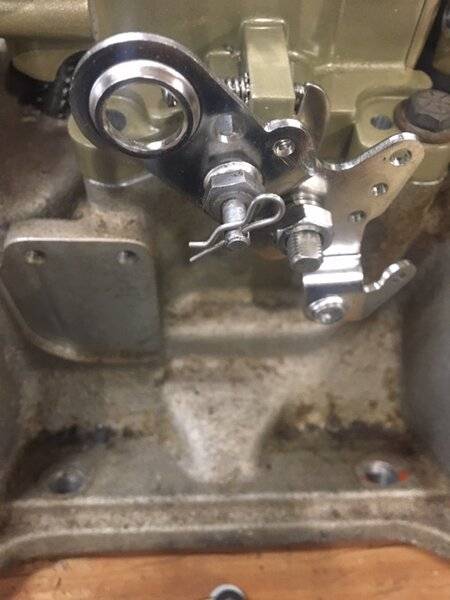

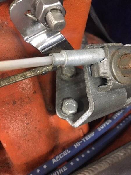

If you want to use the stock Mopar throttle cable stud you need to drill out the center hole to 5/16th or get a new one from Edelbrock or someone.
In my case the throttle cable was just a hair too short, now there are a number of ways to address this; sometimes you bend the bracket a little, you can notch the bracket to allow the cable to slide forward a little or as I did slot out the holes just a little. Its worth noting that you will not need a return spring since all of the TBs have springs on them.

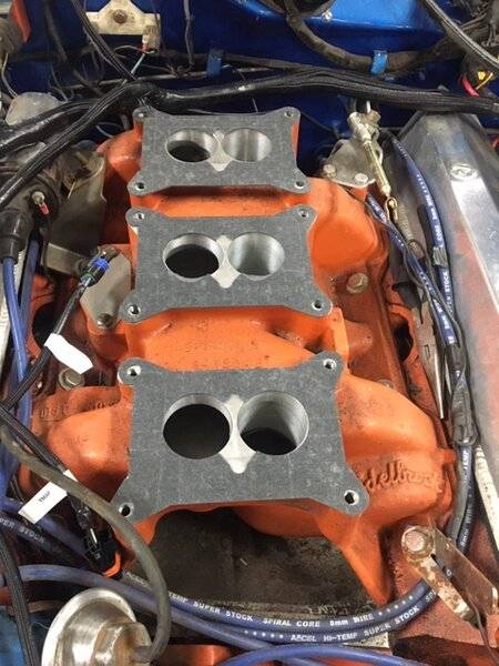

A note here, you want to install the TBs starting at the rear moving forward, so the back one on first, then the middle TB and the forward most TB last (which should have all of the ports in the front along with your relocated MAP sensor.
You need to connect the IAC onto the center TB when you install it because once all 3 are on it is very difficult to get the connector on.
Also worth noting that the gaskets must be put on a specific way, it is covered in the instructions but just in case I am putting it here. Putting them on incorrectly will make the throttle blades stick.
