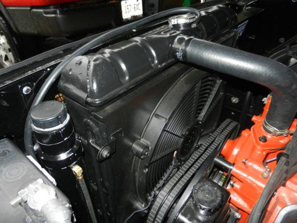

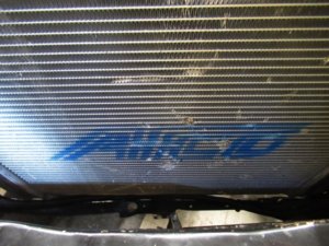

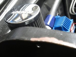

I put a fabricated ( sheet metal shop $50 ) that encapsulates the entire rad face and is sealed all around. This fan mounts nicely in the shroud hole without a great amount of work and the blades are centered with the back face of the shroud. The small looking tube on the left side is an overflow bottle, 25" long and made entirely of 2" ABS pipe and fittings. The white $hit you see is light reflection off the fittings.

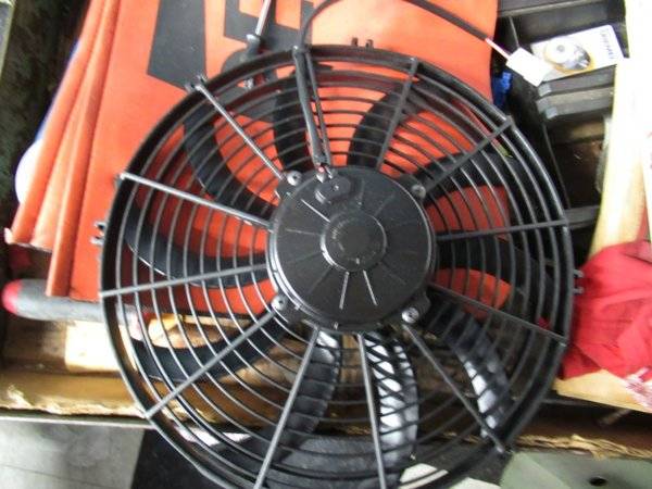

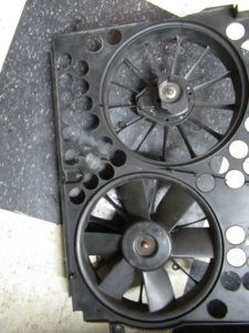

Here is a fan that might work for you but I don't remember manufacturer. Also I used one of cooling components fans on my 40 ford that only had 4.25 inch clearance.

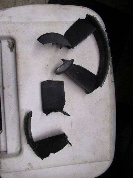

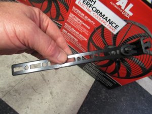

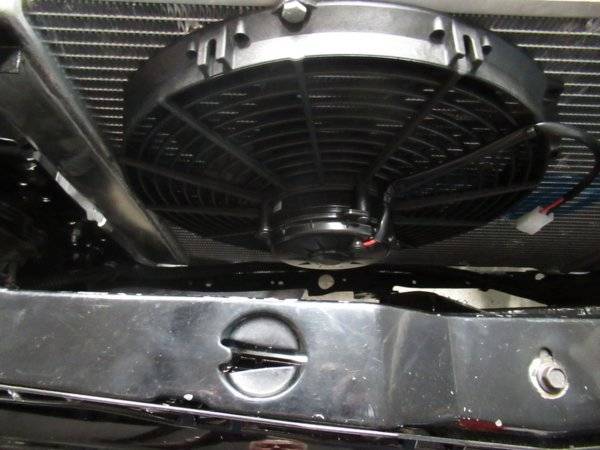

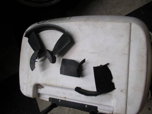

The Spal is fantastic and wish I bought it sooner.The mounting design is great and makes it VERY easy to install.I have NO room between the rad & blower belt.After my junkyard fan exploded and scarred the new aluminum rad,,,installed a 16 inch pusher that blows so hard it cools the water pump!

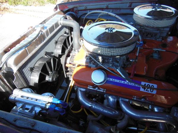

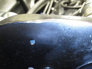

I have very little clearance between the radiator and water pump pulley..i had to cut out some of the fan cage so as to clear the pulley..the pulley barely protrudes into the fan cage..still with plenty of clearance to clear everything...spal 1500 cfm units.now....no more heating problem...it was an air flow thing..

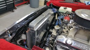

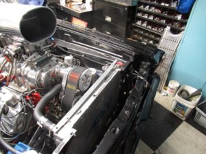

Here is a look at how I have my Coronet set up. I made and polished a custom shroud for 2 Spal 12" pullers and used Derales fan controller. At idle in 95 degree weather it holds it at 180 indefinitely. This is in front of a 700+ hp big block. It took a number of times trial fitting where I was going cut the holes and mount the fans but it fits like a glove in the limited space I have. If you need specific measurements I can get them for you. If memory serves me correctly I had 6" from the face of the water pump housing to the face of the radiator and 3" from the face of the assembled water pump to the face of the radiator. My final clearance is small but hasn't caused any issue so far.

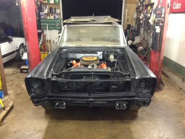

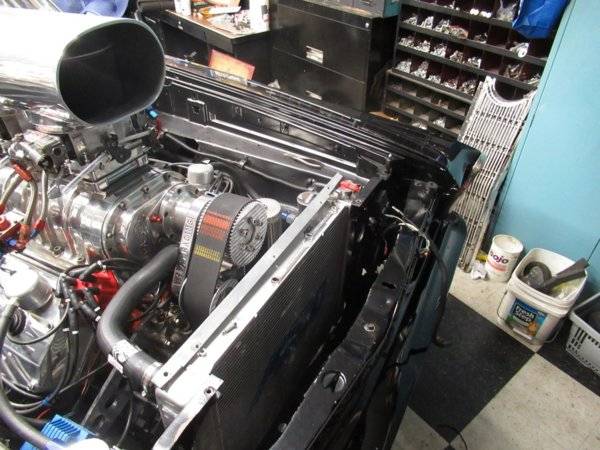

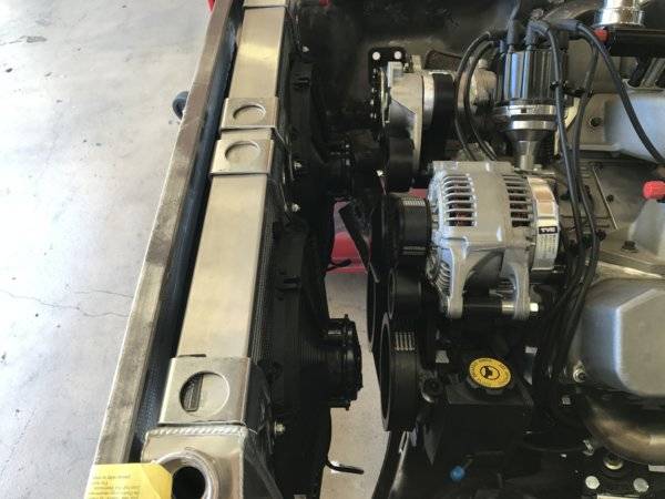

Here is a shot of my car. Some differences that may affect your outcome though, I'm using a 70 k[ moves engine back], made my own core support[ in same location with no difference in radiator location], Be Cool unit with their fans and the serpentine system from Jerry at SD Concepts.
