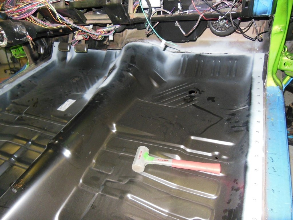

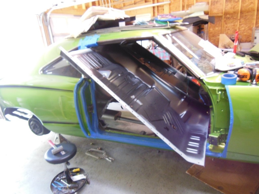

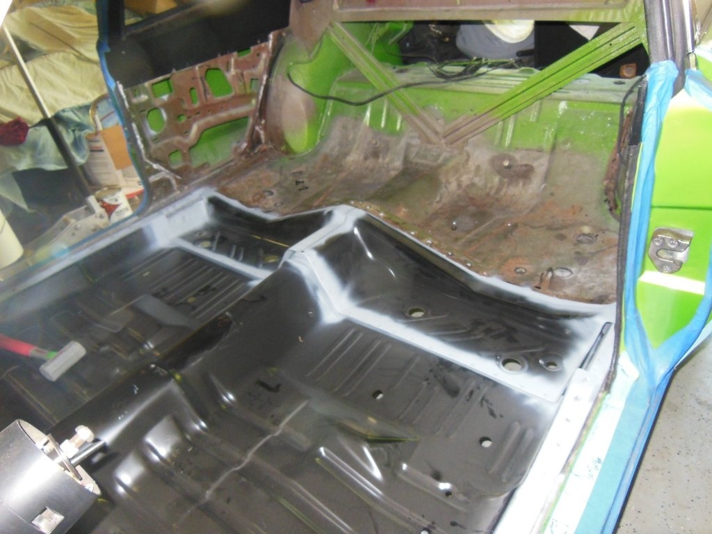

Remeasured diagonally with the doors "off" this time, problem solved. I hate projects that get strung out too long like this, you end up forgetting/ overlooking the obvious solutions. After re-measuring the pan is 56 1/2 and the door opening is 56 3/4, so no problem (famous last words)..... I hope.
Gotta be smarter than the hammer! Thanks for the suggestions guy's. 70B3Bee
Thanks to all who responded the project went great. Putting the seats in next week.
