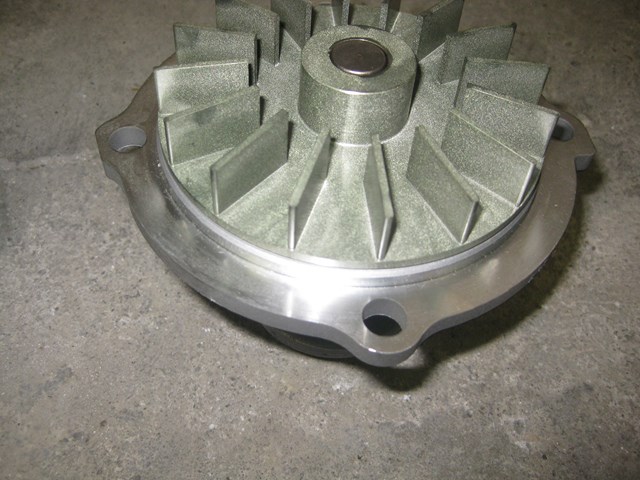

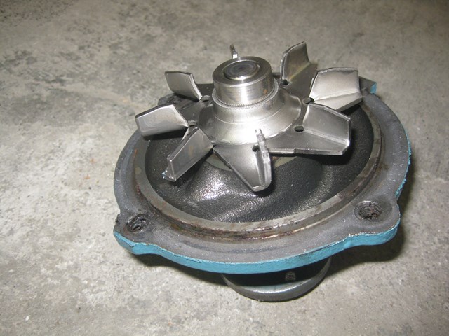

Because my 440 runs a little hot while idling...I changed my waterpump the "old one " had 8 blades /fins with aprox. 3,88 inch diameter.. with a cast iron housing but the new flowkooler pump is not really better... same issue...
Does someone have an idea, what I should do next ?? Going back to a copper/brass radiator ? I don´t what to install E-Fans ..I prefer Stock .
Greetings Juergen
attatched you can see the both waterpumps the upper one is the "old one " the lower pic shows the "new" one

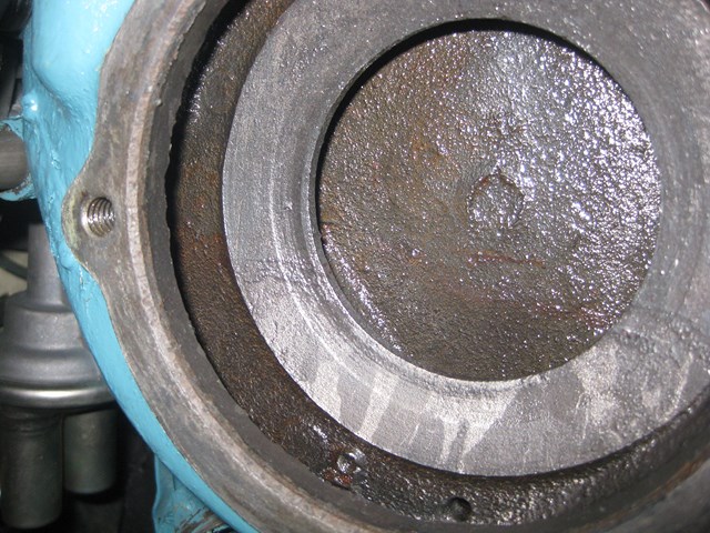

Is the Motor running lean? popping from carburetor? What is diamter of water pump pulley? What is diameter of Crank Pulley? Also measure the distance of pump impellor back to interior back of pump housing. Use clay and press in to the housing and press pump impellor into clay. Distance should be within .060 thousands English to back inside of housing to vane edge.
...the engine is not running lean... idle AFR is about 13.0 Cruise AFR 13.8-14.00 I will check the diameter of the pulleys today... the wp housing is the stock iron one.... ( see the pic ) till now I didn´t messure the distance to the back of the housing...
perhaps a MILODON 16260 High Volume pump would be a better choice, because of the design of their fins.. ?? The Flowcooler looks like a 2 direction pump...

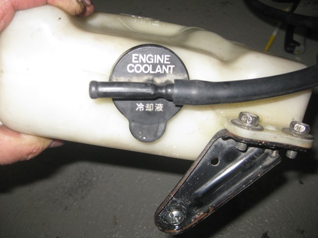

..I think I found the REASON .... when I bought the car, the former owner installed a overflow tank (made in JAPAN!!!) so if the enige runs...and builds up waterpressure the coolant flows into the tank... but if the engine cools down, the radiator cap opens a valve in bottem of the pressure cap and sucks water/coolant back into the radiator...until the system is 100% full ! So the next time when I drove the car..... there is no "room " for circulation... ( that´s what I was thinking about..) now the hoses are softer than before.... also.
So what did I do ???? Simply removed 1.5 Quarts of coolant...and throw the Japaneese Stuff far away.... then off the garage down the road for a ride.... 10 miles.... Water temp : 185 °F next step..... I let the car idle for 6-7 minutes ( after the ride )....Temp : 190°F -195°F.... That it !...
Could it be that simple ??? I hope so.... btw the outside Temp was around 22 -23 °C

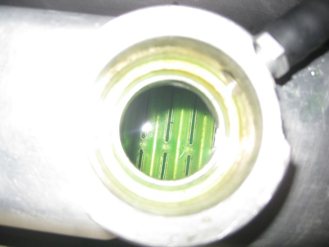

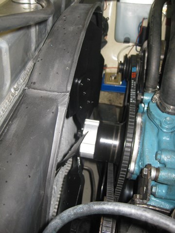

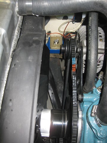

I made some pics also ...from the Radiator / Fanshroud aso
Greetings Juergen
P.S the last pic shows the "BAD BOY ":angry1:

glad to hear things have cooled down for ya. you lucked out with a Japanese part! coulda been much worse! say, Chinese for example.
perhaps those "signs " are chinese also ?? For me it´s the same.... ( don´t need their stuff.... )

The fan blade question..... O.k. the fan blade is about 1.5 inches away from the radiator... afaik . The thing is..if I go towards the radiator..the fan is fully inside the fan shroud ! This is also not so good - right ?

Try the 8 blade as ma mopar engineered. Good luck.
