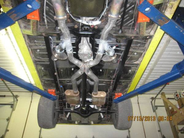

Here’s my old 440 with hooker super comp 1 7/8 headers and flowmaster 40’s dumped at the axle.

Sounds good, Only reason I had the flowmastera they came with the car. New set up runs an 18” extension off the header and that’s it
