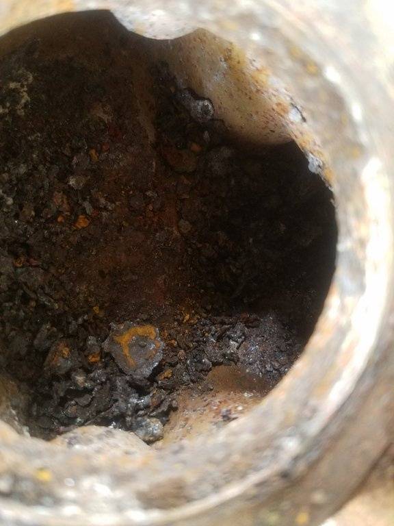

Hey guys, I took off the thermostat housing to replace it and i saw it looked like this. should I just install the new radiator and thermostat and just give it a couple of flushes or should I remove the intake manifold and give it a cleaning?
Small block....if the intake looks like that, I can only imagine what the block looks like. I would flush the block with the radiator out of the picture and then flush the rad on it's own out of the car. If you have access to hot water, that's usually a plus. You could vac that out with a shop vac and then flush up what you could and see what comes up.
Seen worse but most can be cleaned up. Spent a lot of hours flushing one out. Even had to pull the radiator out a couple of times until the engine quit loading it up and that was after flushing the engine many times! A buddy made a tube with a screen to install in the top hose to catch debris but you really have to pay attention to your temp gauge because it didn't take much to clog it and impede flow. It's better than clogging the radiator though but you had better not go very far until things are clean. It was a hassle to clean the radiator but at least when it started clogging up, temps would rise much slower and you could head home and get there before it overheated.

if you wouldn't mind could you tell me how to flush the engine and do a coolant flush without the radiator so I can get to work on that.

I adapted fittings to be able to hook up a garden hose to the lower engine hose and turn on the faucet. Disconnect the upper hose from the radiator and let it dump. You can also get a flush kit from an auto parts store but I think my way was faster. Remove the T-stat either way....run the engine to let the pump to the work. I also like to isolate and flush the heater core separately. Again, I think things go faster doing it like that.
You may want to cut a hose to put on and be able to clamp off so you can fill the block. Then snatch it off and stand back, this will help flush out the back passages. Otherwise it will just be the front your flushing....
Hey guys, I took off the thermostat housing to replace it and i saw it looked like this. should I just install the new radiator and thermostat and just give it a couple of flushes or should I remove the intake manifold and give it a cleaning?View attachment 428203
Damn, that looks like the insides of a porta potty with the water drained out!
I'd not let that stuff go through the radiator or the heater core.
