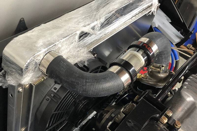

I've also been told by a respected MOPAR engine builder that inline coolant filters are helpful after the system is thoroughly flushed.

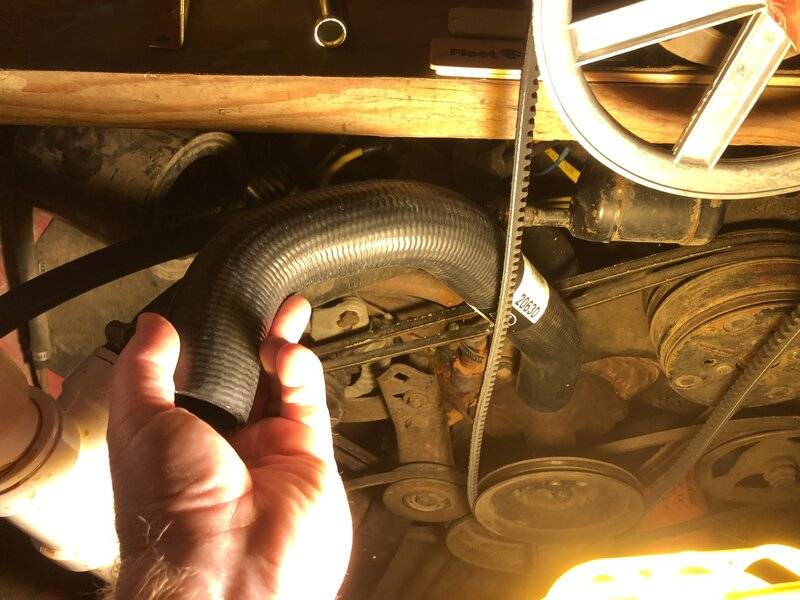

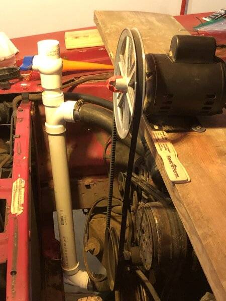

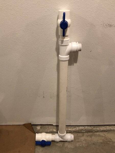

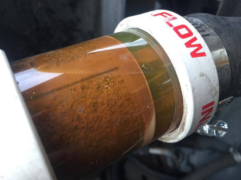

So, what I decided to do was build some piping out of PVC and I added a threaded fitting on top and one on the bottom, along with a couple of valves (Picture 1). I then connected the radiator hoses to this contraption, pulled the 1/4 horse motor out of my drill press, added a bigger pulley, found a belt and mounted it to a 2 X 12 running across my fenders (Picture 2). After some adjusting, I have that running and if calculations are correct, should be spinning the water pump at about 2400 RPMs. I started off by putting some vinegar and water through it, let it sit for a while and I would run the pump for about 5 minutes. I drained all of that out and then just used straight water. The third picture was the second flush. I have flushed about a half dozen times with just water and am still getting brown out of it. The plan, once I get some other stuff buttoned up, is to run 3 to 4 flushes of the Prestone stuff through there, 3 to 4 flushes of straight water, two flushes of Thermocure and then flush with straight water until it is coming out clear. The way the motor sits, it runs clockwise, so it is spinning the water pump the same direction it normally would. I am thinking I might see about reversing the 2 X 12, so then I would be spinning the pump backwards. Not sure if that will break some stuff loose or not. In the mean time I will be working on the other "Stuff". The interior had some mice in it at one point and there was a bunch of crap in the heater box, so I knew I needed to take that out. I also noticed that my heater valve was leaking, so needed to do something with that. Of course heater hoses and radiator hoses and belts all need replaced. Got the new radiator, thermostat, thermostat housing and new water pump, so lots of goodies to put on. Started looking for the Heater valve (Picture 4 below) and it is the black and red variety. After lots of searching and some help from the guy at Oreilly's, found one at Classic Industries. It says for a 75 to 78 Charger (mine is a 73), but exactly what I needed.....not for $300 though. After spending another large amount of time looking I finally decided to go with the metal one (Picture 5 below). The bolt holes do not match up at all and with my car having AC, the lines are right in the way. So, I am going to reach out to a friend that does welding and see if he can make me a bracket, possibly out of aluminum. Finally decided to tackle removing the heater box. Probably was not as bad as I expected. Took hoses loose, AC connections loose, three nuts off of the blower motor housing, four nuts on firewall side holding heater box in, removed and labeled vacuum lines, took two plastic pieces off above the hump. It dropped off the firewall and after a little finagling I was able to get it out of the car. My car is too close to my wall, so can't get the passenger door all the way open, if I could, would have been much easier. Got the heater box split apart and the heater core out. Didn't look too bad, but found a place that said they would pressure test it and check it out at no charge and straighten the tubes going into it. He called the next day with not good news, heater core was leaking. So, could attempt a repair on it or could put a new core in it for $225. I opted to go pick it up and there was no charge. So, then I started the research for the replacement. Never seems like the numbers in the manual match up, but I was finally able to find the replacement on Summit Racing, so that is ordered and hopefully will ship from the factory early next week. Will have to do so cleaning and painting of a rust inhibitor on the firewall inside the car (Picture 6 below) as the mouse nest was right in that area and they must have been peeing all the time back there and pooping. Will just do a quick clean and vacuum and then paint it. Down the road when I am doing a resto on the car, I will repair and/or replace all the sheet metal that has issues. I also bought radiator hoses (Picture 7 is the one on the car now and Picture 8 is the new one) and at least the upper radiator hose is not a match. I thought I had researched the heck out of it and thought I had the right hose. The upper hose I bought is a Gates 20630. Picture on Amazon looks like that is the right one, but on other sites, that same part number shows what i got and it is too tall and won't go under the AC hose.

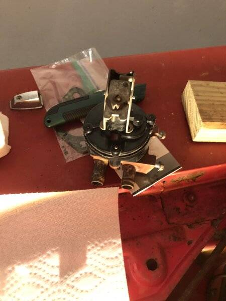

So, probably a little frustrated that it takes so much time to do the research and then I get the wrong part. Probably nothing different than what everyone else experiences.
